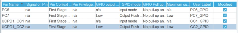

In our project we are using STM32N6.
We want to use UCPD1_CC1 and UCPD1_CC2 pins as a GPIO but CubeIDE does not generate code for these pins as GPIO.
How we can use these pins as GPIO?

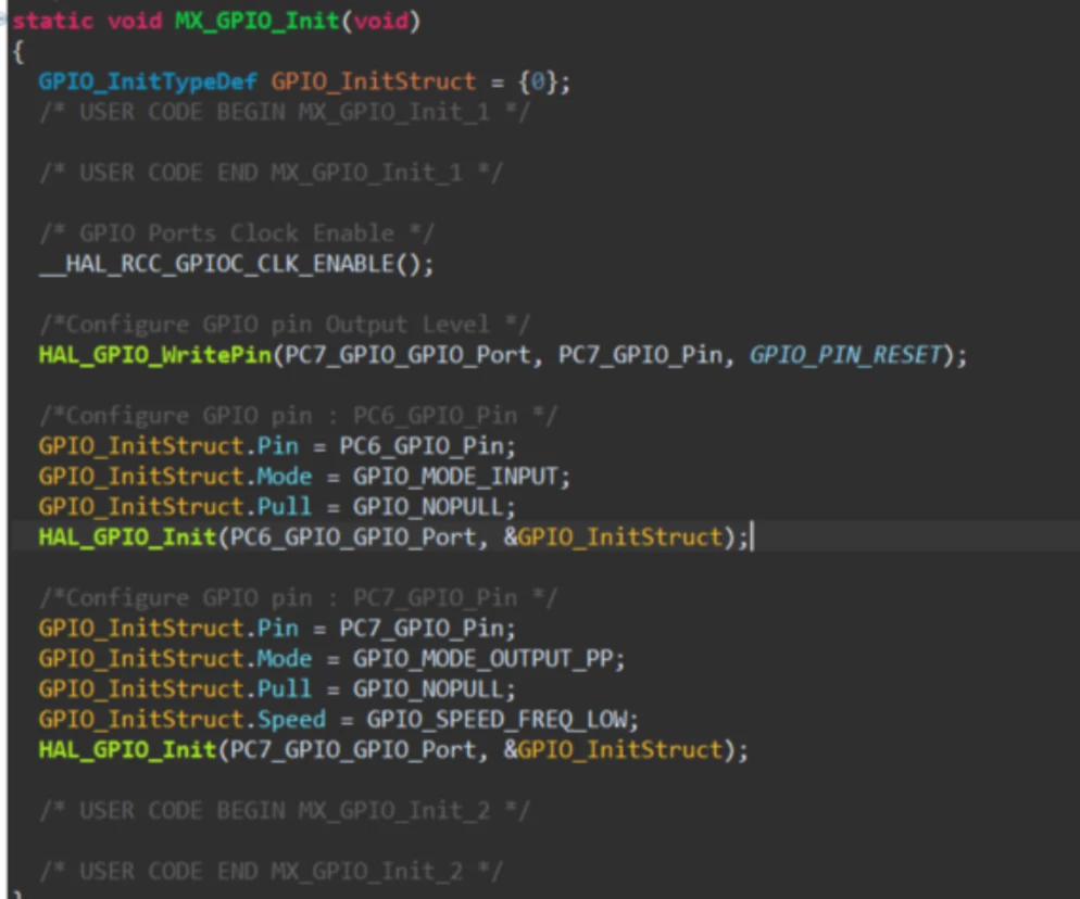

I just create a basic iOC file that,
Select these inputs for FSBL according to the figure.
But for the MX_GPIO_Init there is only PC7 and PC6 pins initialized. I can not see UCPD1_CC1 and UCPD1_CC2 pins.
I have also attached the basic iOC file.

Hi again @Clyasenth
In my understanding, as referenced in datasheet, the function during and after reset is the same as the actual pin name. So, they could not be reused as GPIO.
