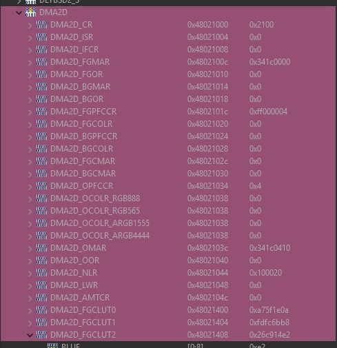

STM32N6 STM32N6570-DK DMA2D Not working
I'm trying to use the LTDC peripheral with DMA2D to be able to send a image to the display without using the CPU
So first i used the example LTDC_Horizontal_Mirroring to have a working LCD . Compiling it i have the dolphin on my screen and flip horizontally.
Next step i used the same config as the project DMA2D_MemoryTo_Memory. So DMA2D in M2M, ARGB4444 in input /ouput alpha input at 0xFF and enable the interrupt (done in my LTDC_Horizontal_Mirroring project)(Also enable I and D cache for cortex M55).
After i used the same code for the dma in the M2M project , but when i use the debug tool or put the ouput buffer in my screen i have only 0.
I checked all register for DMA and the config and adress for in and out (DMA) correspond to the address of the buffer i gave to DMA.
Any ideas ?
Thanks.

DMA2D_HandleTypeDef hdma2d;
LTDC_HandleTypeDef hltdc;
/* USER CODE BEGIN PV */
__ALIGN_BEGIN uint32_t aBufferResult[(LAYER_SIZE_X * LAYER_SIZE_Y * LAYER_NB_BYTES_PER_PIXEL) / 4] __attribute__((aligned(16))) __NON_CACHEABLE = {0};
/* ARGB4444 input buffer 16bpp */
__ALIGN_BEGIN uint32_t aBufferInput[(LAYER_SIZE_X * LAYER_SIZE_Y * LAYER_NB_BYTES_PER_PIXEL) / 4] __attribute__((aligned(16))) =

 MX_LTDC_Init();
 MX_DMA2D_Init();
 /* USER CODE BEGIN 2 */
 BSP_LED_Init(LED1);
 BSP_LED_Init(LED2);
 /* DMA2D Callbacks Configuration*/
 hdma2d.XferCpltCallback = TransferComplete;
 hdma2d.XferErrorCallback = TransferError;
 /* Start DMA2D transfer*/
 if(HAL_DMA2D_Start_IT(&hdma2d,
 (uint32_t)&aBufferInput, /* Source memory buffer */
 (uint32_t)&aBufferResult, /* Destination memory buffer */
 LAYER_SIZE_X, /* Width of the 2D memory transfer in pixels */
 LAYER_SIZE_Y) /* Height of the 2D memory transfer in lines */
 != HAL_OK)
 /* Initialization Error */
 Error_Handler();
 /* Wait for the end of the transfer*/
 /* Before starting a new transfer, you need to check the current state of
 the peripheral; if it is busy you need to wait for the end of current
 transfer before starting a new one.
 For simplicity reasons, this example is just waiting till the end of the
 transfer, but application may perform other tasks while transfer operation
 is ongoing. */
 while (HAL_DMA2D_GetState(&hdma2d) != HAL_DMA2D_STATE_READY)
 HAL_Delay(100);

HamadyAuthor
March 28, 2025
For info here all registers
