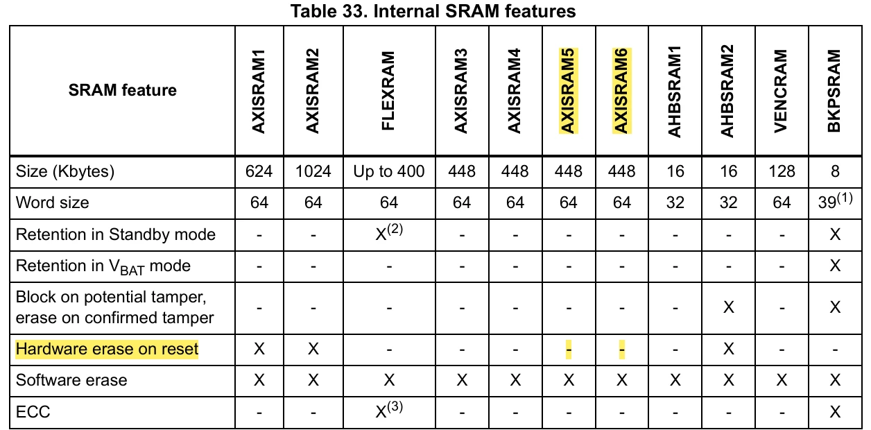

I'm implementing Over-the-air firmware updates for a board using the STM32N657 MCU.
In the Appli, I download the new firmware binary over Wifi and store it to RAM at a fixed location in AXISRAM5 and 6. In order to flash the new binary to the OctoSPI Flash I prepend a "magic" header to the new firmware binary (still in RAM) and then restart the MCU using `HAL_NVIC_SystemReset`. Then, after this reset the FSBL checks the fixed location in RAM for the "magic" header. If present, it should flash the OctoSPI Flash with the new firmware binary using the ExtMem Manager (I cannot just flash directly from Appli because I use XIP and hence the Appli is running from OctoSPI in memory-mapped mode, preventing writes). I've done similar things with other MCUs and it worked perfectly fine.
However, it looks like on the STM32N6, the contents of AXISRAM5 and 6 are not preserved across software resets. At least, checking the "magic" header in FSBL always produces randomly looking results that are also different each time I try. Is there a way to preserve contents of AXISRAM5/6 across resets? Do I need to configure something for this to happen (e.g. is there some security feature that resets RAM contents, or the BootROM doing stuff, etc)?
I have disabled the D-Cache and MPU to rule this out as a source of issues, and am also very sure that this is not the usual problem of the C-runtime initialization overwriting the values (since they are different each time, and also because the memory buffer isn't even present in the Linker script - I just access it directly by address).

Hello @asdfasdf
I just tried your project on my side.
Indeed, the content of AXISRAM5 is lost after a System Reset.
After internal confirmation, this is due to the default shutdown mode of SRAM3 to SRAM6. This corresponds to bit 20 (SRAM SD) of the RAMCFG_AXISRAMxCR registers (with x = 2 to 6).
In RM0486, the reset value of the RAMCFG_AXISRAM3CR to RAMCFG_AXISRAM6CR registers is 0x0010 0000.
As a result, by default, the internal power supply of the concerned SRAMs is turned off to reduce power consumption on VDDCore. Consequently, their content is not guaranteed after a System Reset.
Therefore, important clarifications need to be made on our side in this reference manual, starting from section 10.3.1 "Internal SRAM features" and especially in Table 33 "Internal SRAM features."
Please note that for SRAM1 and SRAM2, the default value of bit 20 (SRAMSD) is 0x0000 0000. However, their content is erased by a system reset.
For your application, you can use the 80kB of retention RAM (between 0x3400 0000 and 0x3401 4000) or the Backup RAM, which is in the VBAT domain (only 8kB !).

That table is the reason I used AXISRAM5/6 in the first place:) However, I'm just not sure whether there are other components in the N6 that erase the memory that I have missed in the thousands of pages of reference manual. E.g. all the security features, BootROM, etc, there simply are a lot of moving parts on the N6 that are easy to miss.
