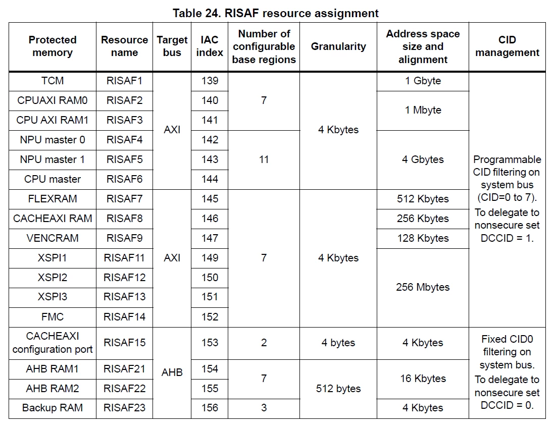

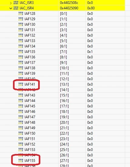

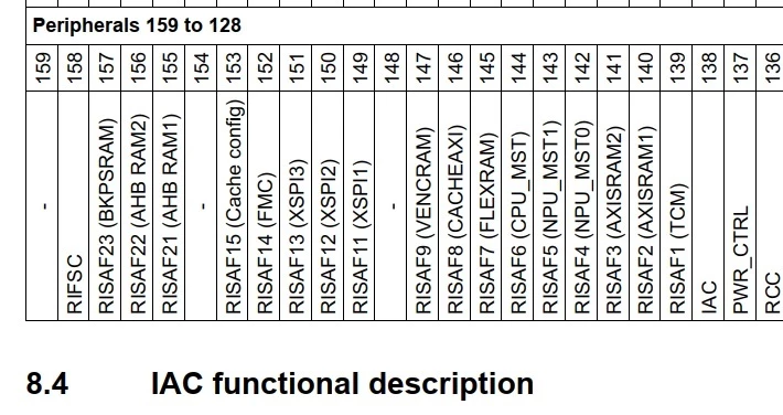

Jul 23, 2026 10:02 AM UTC
Thanks to the author for the tip! It helped me too.
  Note that my DMA buffers were allocated in a separate area around these addresses 0x38000000
  (I disabled the DMA cache). Accordingly, I used RISAF21 instead of RISAF3.
The program still refused to work. Then I used a wonderful tool and recommend it to you.
  Run your code in debug mode, stop it somewhere in the middle of the process, and when you realize that what you're trying to do isn't working, open the SFRs tab and find the register block for the IAC.
  Look for which IAF flag is set to 1 and find it in Datasheet RM0486, Section 8. There are tables there. Then you'll know exactly which device was blocked. You can see my case on IAC_Reg.jpg and piece of table from Datasheet - RISAF.jpg
In my case, this was my own DMA buffer in AHBSRAM1 - IAF155 and, as I later discovered, my own DMA handlers located in the main memory of AXISRAM2 - IAF141.
So, following the author's example, I placed two groups of register operations (for RISAF3 and RISAF21) inside the SystemIsolation_Config() function. It all worked!
Thanks again for the tip.
