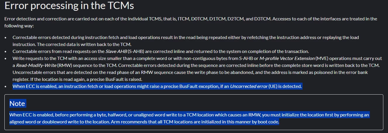

There is ECC in the TCM memory and it is under the control of the CPU. Please refer to the Arm Cortex-M55 Processor Technical Reference Manual r0p2. See at the bottom of the page below (Error processing in the TCMs): https://developer.arm.com/documentation/101051/0002/Reliability--Availability--and-Serviceability-Extension-support/ECC-memory-protection-behavior/Error-detection-and-processing
The TCM needs to be initialized before use it. Here is a snipped assembler code that you will need to add in the reset handler of your startup_stm32n657xx.s file (replace the Reset_Handler function)

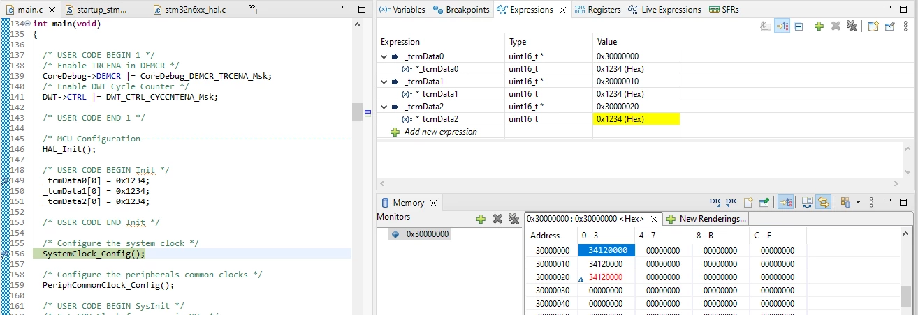

 And with my code:
/* USER CODE BEGIN PV */
uint16_t* _tcmData0 = (uint16_t*)0x30000000;
uint16_t* _tcmData1 = (uint16_t*)0x30000010;
uint16_t* _tcmData2 = (uint16_t*)0x30000020;
/* USER CODE END PV */
int main(void)
 /* USER CODE BEGIN 1 */
 /* USER CODE END 1 */
 HAL_Init();
 /* USER CODE BEGIN Init */
 _tcmData0[0] = 0x1234;
 _tcmData1[0] = 0x1234;
 _tcmData2[0] = 0x1234;
 /* USER CODE END Init */
 SystemClock_Config();
After that, whatever you do with the TCM memory, you should also define these corresponding regions in the linker file. This is how it should be done.
Remember that on one side there is a STM32N6 device which is a complex SoC. And on the other side there are the compiler tools. For both to match and work, there are these best practices that must be applied.
I hope it will fix your hardfault issues when you use TCM with STM32N6. Let me know.

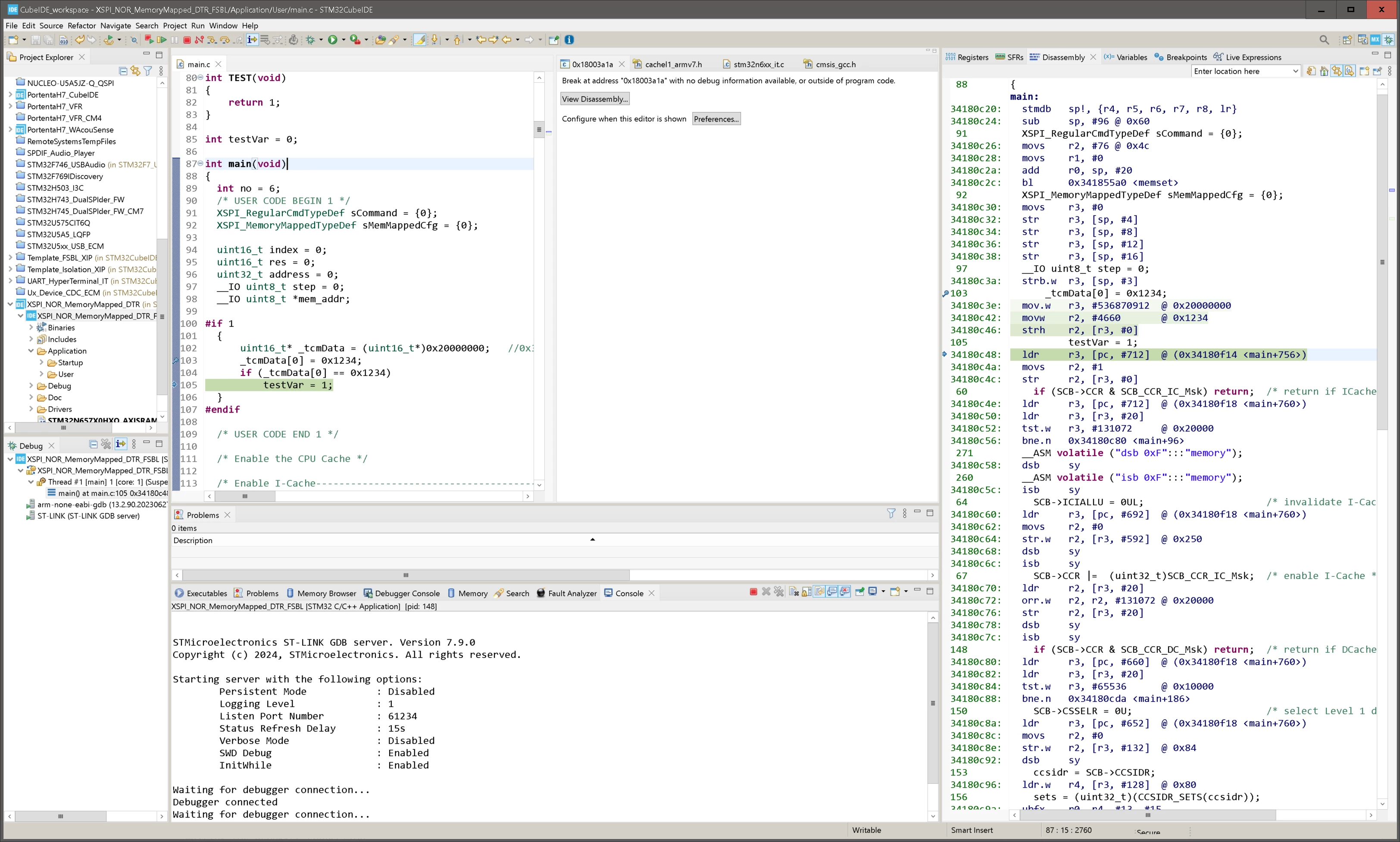

VERY INTERESTING (and confusing)!
I play right now also with the STM32N6 - I tried your issue on on my project... and YES: it can crash in HardFault_Handler (but see below: it depends just on how you compile with debug options!)
First, I thought:
A non-secure vs. secure issue (DTCM 0x30000000 is Secure, 0x20000000 is Non-Secure). So, accessing DTCM as secure when main() is launched as non-secure (potentially) could cause such an issue. But it does NOT!
It just depends on:
How you set Optimization level! VERY STRANGE:
  • if I set Optimization level to "none (-O0)" - it crashes in HardFault_Handler!
  • if I set "Optimize for debug (-Og)" - it WORKS!
I use an STM32N6 project with FSBL build. It really just depends on how I set the debug level!
Secure and non-secure address location does not have an effect! (it crashes with both address locations if not -Og!)
What is this?
(I have realized already: the STM32N6 is very "delicate": sometimes it works, sometimes not - it seems to depend meanwhile on "how" I generate the code (with vs. without debug optimization, FSBL vs. Appli, ...).
Here the details:
I do also in main():
int main(void)
 int no = 6;
 XSPI_RegularCmdTypeDef sCommand = {0};
 XSPI_MemoryMappedTypeDef sMemMappedCfg = {0};
 uint16_t index = 0;
 uint16_t res = 0;
 uint32_t address = 0;
 __IO uint8_t step = 0;
 __IO uint8_t *mem_addr;
#if 1
	 uint16_t* _tcmData = (uint16_t*)0x20000000;	//0x30000000 is secure memory, 0x20000000 is non-secure
	 _tcmData[0] = 0x1234;
	 if (_tcmData[0] == 0x1234)
		 testVar = 1;
#endif
Just toggle debug level for code generation!

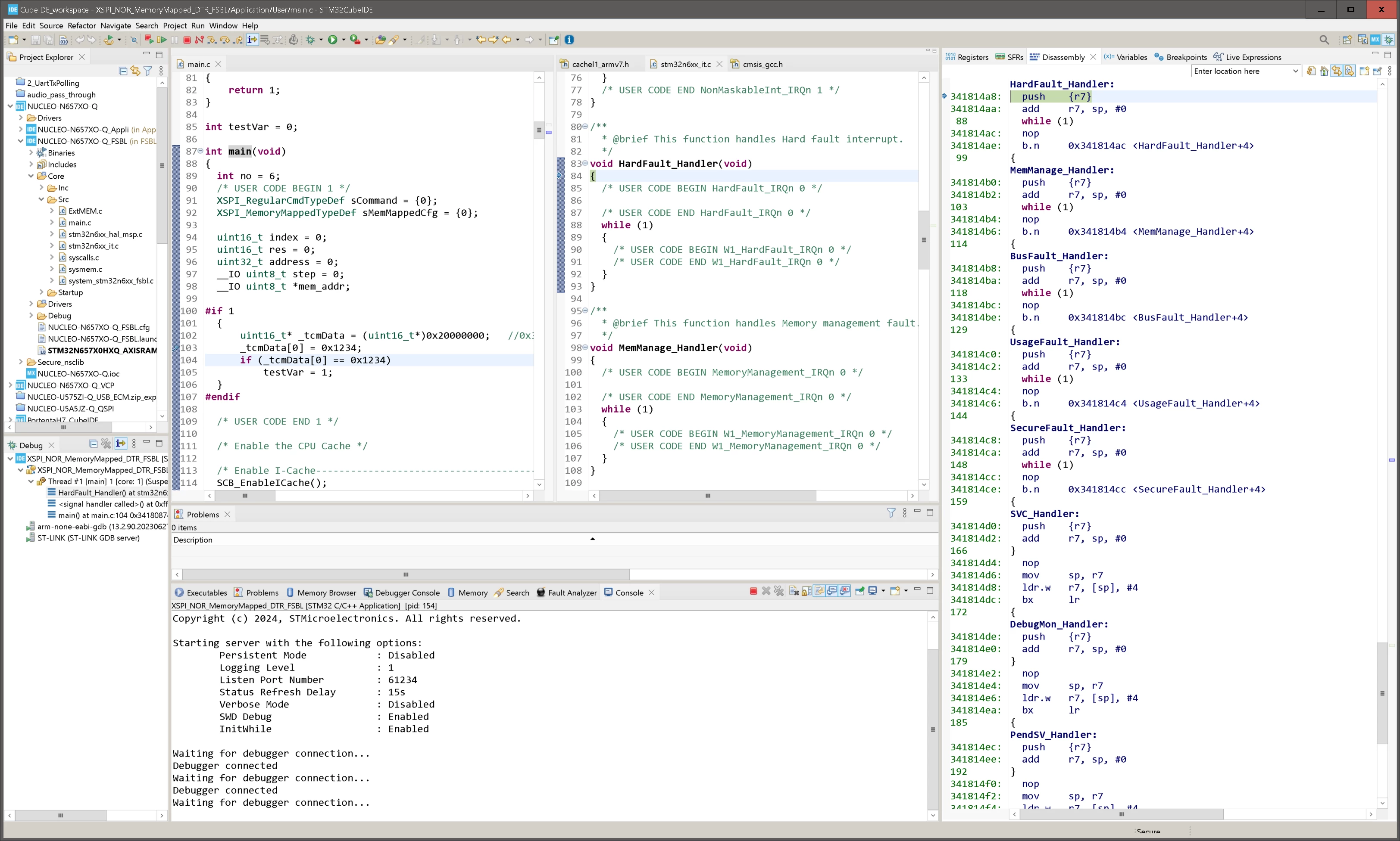

This is a debug session with debug level -Og:
This works fine!: I can write and read DTCM as secure and non-secure (0x30000000 vs. 0x20000000).
This is a debug session with none, as -O0:
This CRASHES: both addresses accessed result in a HardFault_Handler.
What is this?
I assume: the debugger has an effect on secure vs. non-secure access permission or system configuration done (by debugger instead of code).
(the system behavior should not not have any effect if generated for debugger and/or using debugger to let execute my code)
I am pretty "shocked" being able to replicate this issue (and I am very confused, losing my confidence in this N6 MCU...)

filipxsikora
Jan 4, 2025 2:15 PM UTC
@RomainR. Thank you! This works.
I realize, that the M55 core is different from M7 core. But I just never knew that the ITCM/DTCM memories need some kind of "init". I've modified your snippet to also init ITCM memory
/* Clear I-TCM */
 ldr R0, = 0x10000000
 ldr R1, = 0x10010000
 mov R2, #0
clear_itcm:
 str R2, [R0]
 add R0, R0, #4
 cmp R0, R1
 bcc clear_itcm
And now DTCM and ITCM are both available, readable and accessible. Awesome, thanks again.

What is the conclusion? For my impression: TCMs have ECC, always on. On startup - it looks like - there is a mismatch between random RAM content and CRC. So, it needs a "clear" cycle, to initialize TCMs first before first use (to bring RAM content and ECC into "sync").
Anyway: an "interesting feature" (compared to H7 MCUs).
Lead II
Jan 4, 2025 11:18 PM UTC
I cannot stop thinking about this "issue". I want to understand completely what is going on. What I come across is this:
  • Yes, you have to initialize DTCM and ITCM first (before you read back anything or execute code):
    This seems to be done by initializing (writing) N numbers of words (assuming it is related to the row length for the ECC calculation, complete "pages" have to be written so that ECC is "in sync")
  • In my experience: it is important to write 32bit values (not uint_16), assuming the ECC "update" is done just on 32bit write cycles (otherwise is still crashes with HardFault_Handler).
