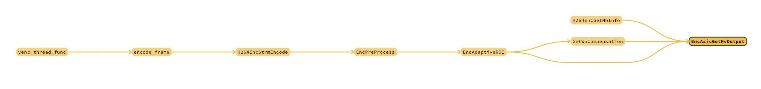

I'm not a VENC expert. According to the name of the API, EncAsicGetMvOutput in encasiccontroller.c (inside STM32Cube_FW_N6_V1.0.0\Middlewares\Third_Party\VideoEncoder\source\common) looks like what you need:
 EncAsicGetMvOutput
 Return encOutputMbInfo_s pointer to beginning of macroblock mbNum
u32 * EncAsicGetMvOutput(asicData_s *asic, u32 mbNum)
The usage of this API in the example VENC_USB (inside STM32Cube_FW_N6_V1.0.0\Projects\STM32N6570-DK\Applications\VENC) is shown below for your reference:

Thank you, this was certainly helpful. I haven't tested it out yet, but it did point me to the correct portion of the VENC demo provided for the DK. As part of that demo, the `encOut` struct already contains a pointer to the macroblock motion vectors.
