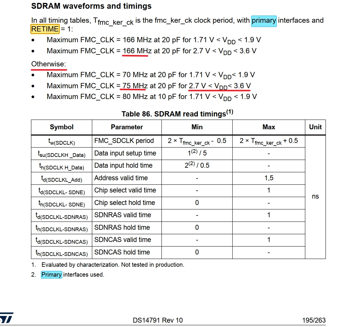

STM32N6 FMC SDRAM: what does "Primary interfaces used" mean, and which pins are the primary ones?
  We are designing a board with STM32N647X0H3Q (VFBGA264) and a 16-bit SDR SDRAM
  (512 Mbit, x16, 3.3 V LVTTL) on the FMC, and we would like to run SDCLK at 133 MHz
  and 166 MHz.
  In DS14791 Rev 10, section "SDRAM waveforms and timings", the text says:
    "In all timing tables, Tfmc_ker_ck is the fmc_ker_ck clock period, with primary
     interfaces and RETIME = 1:
     - Maximum FMC_CLK = 166 MHz at 20 pF for 2.7 V < VDD < 3.6 V
     Otherwise:
     - Maximum FMC_CLK = 75 MHz at 20 pF for 2.7 V < VDD < 3.6 V"
  and Tables 86 to 89 have note 2: "Primary interfaces used."
  However, I could not find a definition of "primary interfaces" anywhere in DS14791,
  RM0486, AN5967 or ES0620, and the CubeMX device database shows no difference between
  the alternative pins of the same FMC signal.
  On VFBGA264, the control, address, SDCLK and NBL signals each have only one pin, but
  every data line has two or three possible pins (all AF12), for example:

  My questions:
  1. What exactly does "primary interfaces" mean for the FMC SDRAM timings?
  2. Which pin for each of FMC_D0 to FMC_D15 belongs to the primary interface on
     VFBGA264? Are the control/address/SDCLK/NBL pins (single option) all primary?
  3. We may also use VFBGA178 (STM32N645I0H3Q). On that package some data lines have
     only one option (for example FMC_D0 = PA12 only). Which pins are primary on
     VFBGA178, and is 166 MHz possible there at all?
  Thank you in advance.

STOne-32Best answer
Oct 6, 2026 6:55 AM UTC
Dear ​@Yulai ,
Thank you for the question, we will add a clarification for the pins /IO belonging to the primary interface in our documentation.
Here are the full conditions for FMC_CLK :
Maximum FMC_CLK =166 MHz at 20pF  for 1.71V<VDD<1.9V.
Maximum FMC_CLK =166 MHz at 20pF  for 2.7V<VDD<3.6V.
  • Primary interface ( see below)
  • SYSCFG_FMC_RETIMECR = 0x2:
  • FMC_SDRAM_RPIPE_DELAY = 1;
Regards,
STOne-32

YulaiAuthor
Oct 6, 2026 8:40 AM UTC
  Thank you very much, this is very helpful.
  One follow-up: on VFBGA178 (STM32N645I0H3Q), PB15, PB8, PB9, PB13 and PB14 are not bonded, so FMC_D0/D1/D3/D5/D7 can only use PA12/PA11/PA9/PA2/PA0. Does this mean that x16 SDRAM on VFBGA178 is limited to 75 MHz (3.3 V), or is there another primary option on that package?
STOne-32
Oct 6, 2026 1:06 PM UTC
Dear ​@Yulai ,
Indeed, this is correct and if we need x16 SDRAM at 166MHz, the choice of the package is key.
Regards,
STOne-32
YulaiAuthor
Oct 7, 2026 3:19 AM UTC
OK. In that case, we have to abandon VFBGA178 and switch to VFBGA264 instead. Thank you again.
