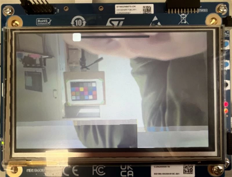

Hey all,
I have a Sony IMX686 camera module connected to the STM32N6 Discovery Kit, streaming video to the on-board LCD. The sensor outputs a single-stream RAW Bayer format on Virtual Channel 0, and the DCMIPP receives the data correctly — up to a certain horizontal resolution. The issue appears to be related to a bytes-per-line limit within the DCMIPP or its DMA pipeline.
When the IMX686 outputs RAW8, the DCMIPP can only handle horizontal line lengths up to 1552 pixels. If I increase the width beyond 1552 px (e.g., to 1668 px), I begin to see horizontal distortions in the lower portion of the frame. These distortions worsen as the width increases. See the images below.
As the width increases further, the distortion grows and eventually affects most of the frame (shown below).
When switching the sensor to RAW10, the exact same distortion appears, but it goes away when I reduce the horizontal resolution to 1232 pixels. This matches the expected scaling:
1552 * 8 / 10 ≈ 1241 → nearest practical width/alignment is 1232
This makes it look like the system is hitting a maximum bytes-per-line limit that is the same for RAW8 and RAW10.

Simon V.
January 12, 2026
Can you please share your code source ? It may be relative to output buffer definition and active SRAMs.
It is important that the output buffer size should  correctly size to correctly generate the end of frame and line.
Thanks in advance,
Regards,
Simon
bwelte1AuthorBest answer
January 13, 2026
Hey Simon, thanks for the response.
In the end there was a misconfiguration in the IMX686 image sensor. Everything on the DCMIPP side is working great! This issue can now be seen as resolved :).
Thanks again
