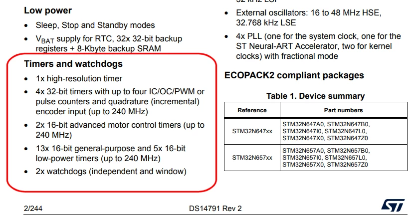

Hello ST,
The STM32N6 Datasheet (DS14791 Rev 2) claims that the device has 1 HR Timer and 4x 32-bit General Purpose Timers, yet the Functional Overview section does not support these claims.  Nor does the Reference Manual (RM0486 Rev 1).  Could you please cdis-ambiguate for us, and mark the incorrect documentation for revision?
Also, is it really true that the DP-FPU capability is not present:-(
Thank you!
Indeed it does:
https://www.st.com/en/microcontrollers-microprocessors/stm32n647i0.html

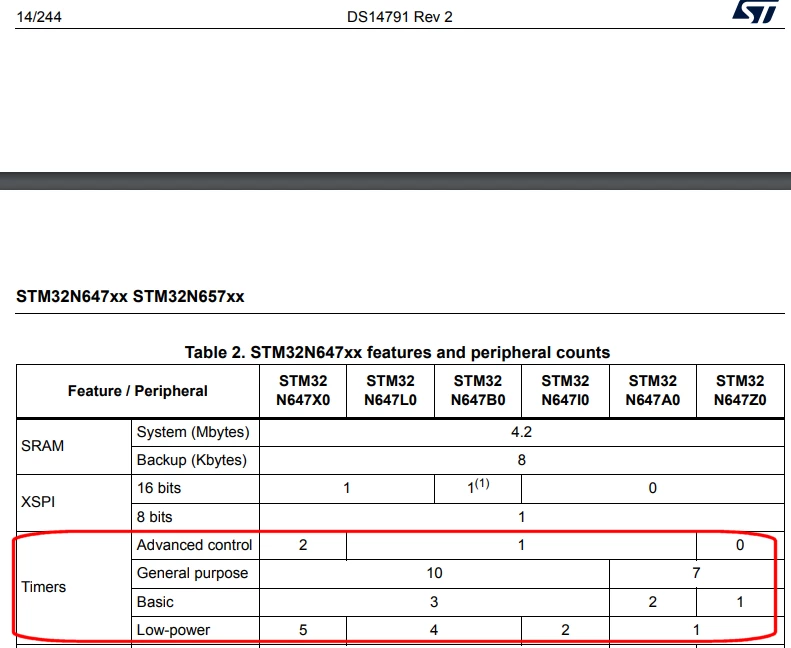

Indeed:
Plus:
  • Only 10 GP timers;
  • Those claims should be prefixed with, "up to...".
