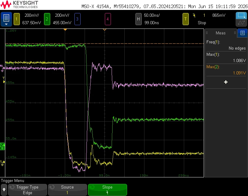

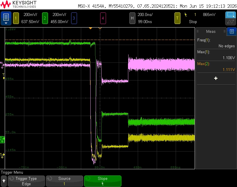

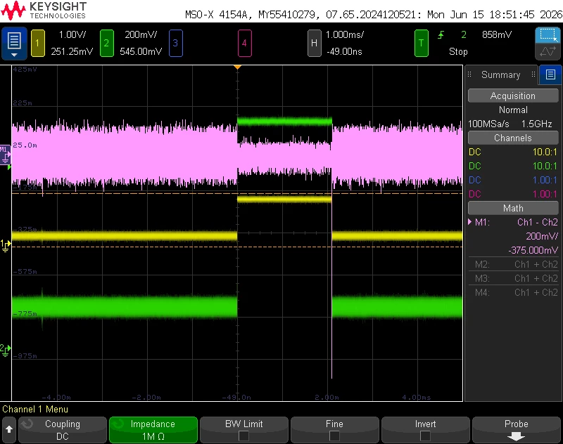

Please find three oscilloscope captures attached, all measured at the STM32N6 CSI input pads (after a ECMF240A100N6 common-mode filter). Note that our oscilloscope is only 1.5GHz.
scope_6: Wide view at 1 ms/div showing the periodic HS burst structure. LP-11 idle regions and continuous HS clock activity are visible.
scope_11: LP -> HS entry sequence at 50 ns/div. Left side shows LP-11 at approximately 1.09 V per line. The LP-01 intermediate state is visible (CK_P drops first), followed by LP-00, then HS burst onset. This sequence is arriving intact at the MCU pad.
scope_12: Same LP -> HS entry at 200 ns/div showing fuller context. LP-11 stable region on the left, full transition sequence in the middle, HS burst settling on the right.
Summary of measured values at the STM32N6 pad:
    •    LP-11: CK_P = 1.106 V, CK_N = 1.111 V
    •    HS common mode: approximately 190 mV
    •    HS differential amplitude: approximately 140 mVpp
    •    LP -> HS entry sequence: complete and intact, LP-01 step visible
The signal integrity at the MCU pad is confirmed. Given this, we are confident the issue is not in the physical signal path. The question remains why the SNPS D-PHY clock CDR does not respond to this input.
