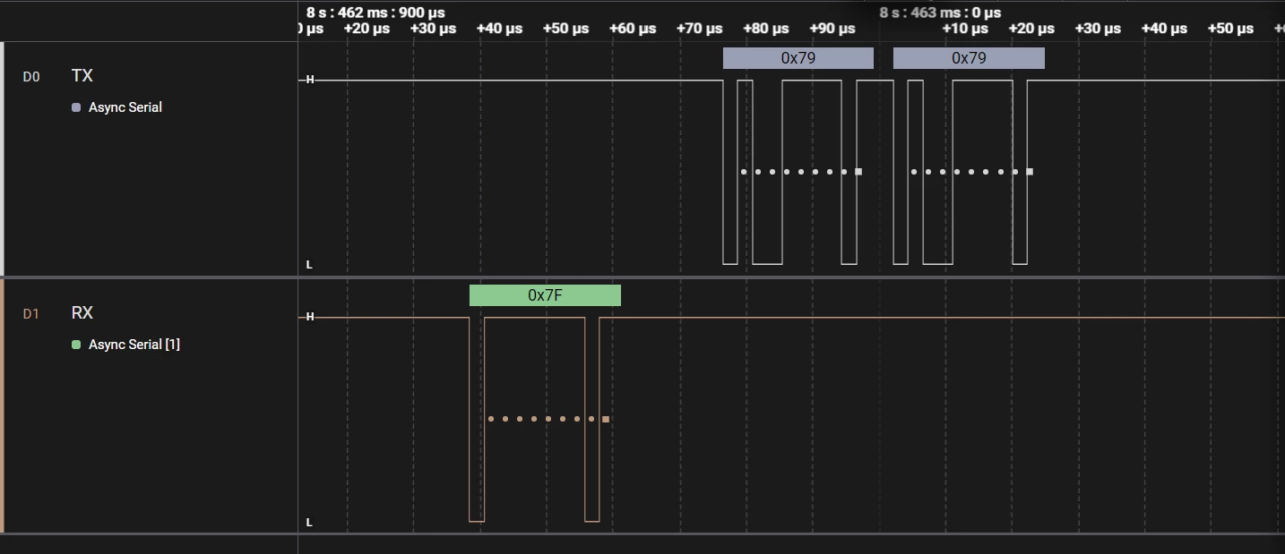

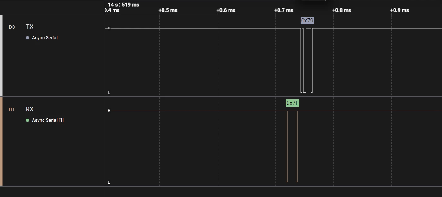

When sending the first initial SYNC (0x7F) byte to the STM32N6 boot ROM over UART, the boot ROM replies with two ACK (0x79) bytes, while only one ACK is sent as a response to later SYNCs. Is the boot ROM guaranteed to always reply with two ACKs to the first SYNC?
First sync:
Later syncs:

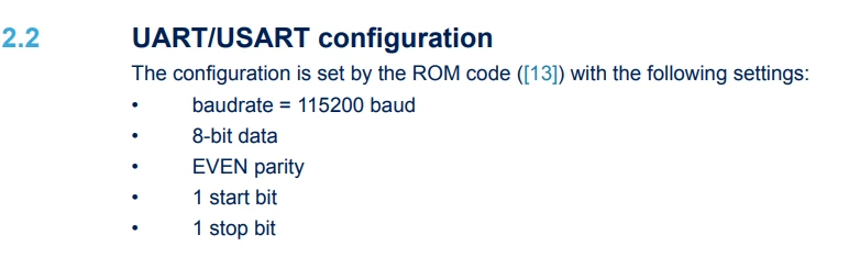

Just to ensure you followed the following parameters from the AN5275
Tuomas95Author
Jun 17, 2026 11:07 AM UTC
yes, expect I’m using baudrate of 460800. UM3234 does not specify the allowed baudrate range.
mƎALLEm
Jun 17, 2026 11:45 AM UTC
Try the parameters provided in the AN5275
