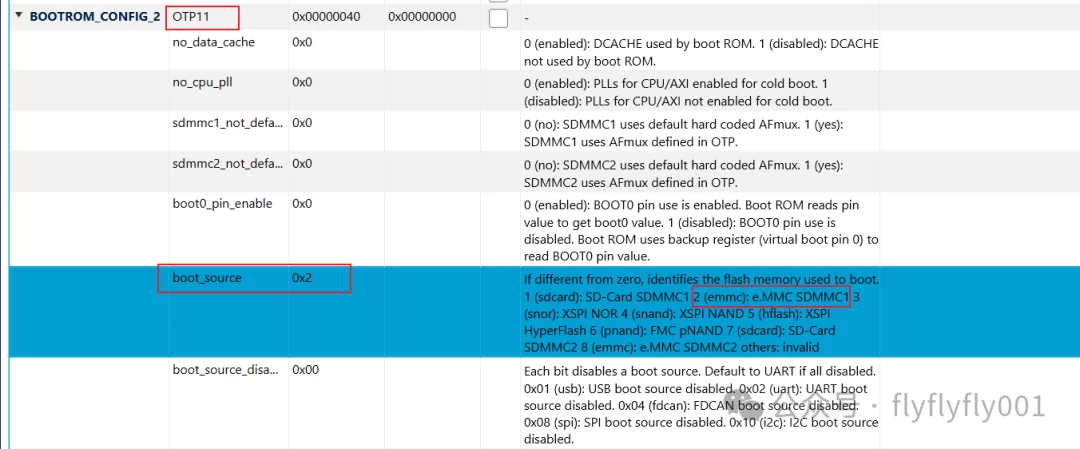

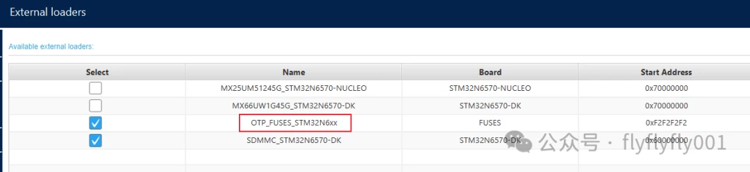

Open STM32CubeProgrammer software, check OTP_FUSES_STM32N6xx in External loaders, as shown below.
On the OTP page, change the boot_source of OTP11 of the STM32N6 chip to 2, indicating booting from EMMC1 (the default 0 is NorFlash booting), as shown below.

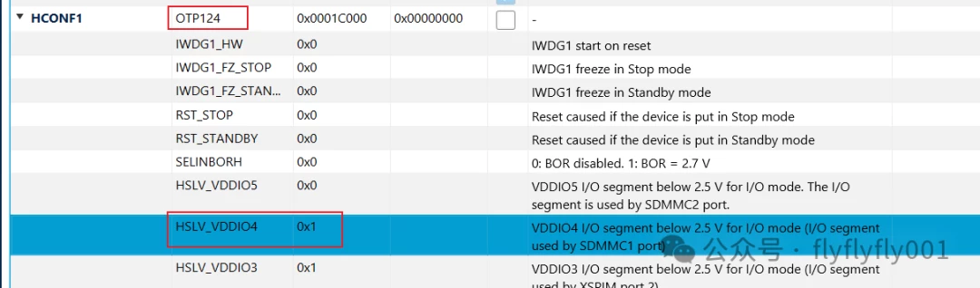

If you are using 1.8V IO, HSLV_VDDIO4 of OTP124 also needs to be set to 1 to improve performance. (The power domain of EMMC1 uses VDDIO4)

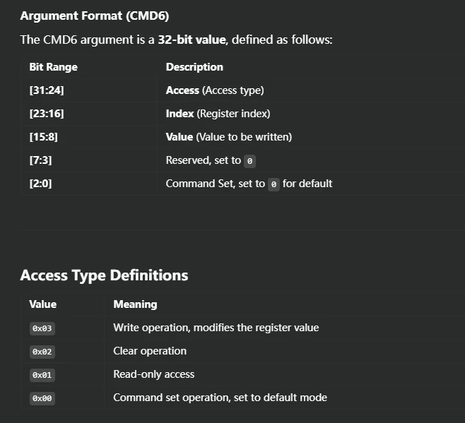

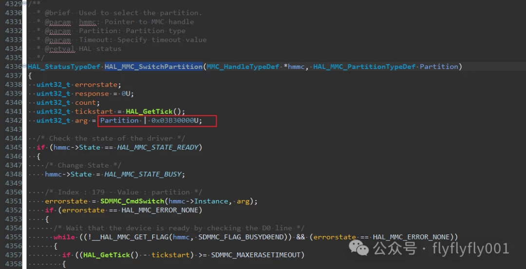

2.2 CMD command analyse
Going deep into the function HAL_MMC_SwitchPartition, we can find that the function parameter Partition will "OR" the value 0x03B30000 and then sent to EMMC.
Here 03(Hex) represents the access type, and B3(Hex) is the index of the EXT_CSD register to be accessed, which is 179(Dec). So this function can be used to specifically access the EXT_CSD[179] register. If you want to access other registers, the method is similar. The cmd format can reference as below.

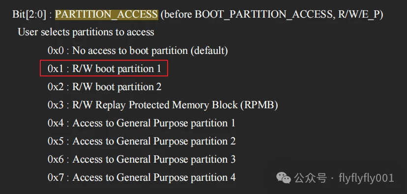

EMMC has USER partition, BOOT partition 1 and BOOT partition 2. By default, the USER partition is accessed when powering on. You need to switch to the BOOT partition 1 and write FSBL.bin into it. The method is as follows.
Still in the EXT_CSD[179] register, set bits[2:1] of the register to 1, indicating that you want to access the BOOT partition 1.
Simple example code can references as below. HAL_MMC_BOOT_PARTITION1 is a macro defined by ST, and its value is 0x00000100, which is consistent with the register writing method introduced before.

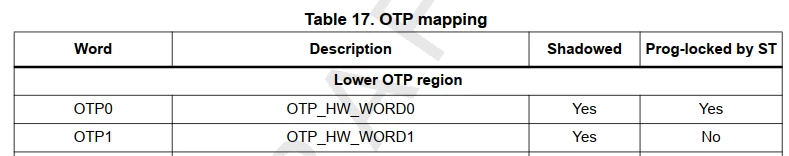

It is true that programming OTPs must be done with caution as it is irreversible.
Regardless of your article, note also that some OTPs are marked as shadowed in RM0486 Rev2 in table 17.
OTP mapping. It is possible for the user to read and write these shadowed OTPs by firmware in secure mode without physically changing the OTP configuration.
This is only possible for the list of shadowed OTPs using the BSEC functions in the driver stm32n6xx_hal_bsec.c.
  • HAL_StatusTypeDef HAL_BSEC_OTP_ReadShadow()
  • HAL_StatusTypeDef HAL_BSEC_OTP_WriteShadow()
More information in RM0486 Rev2 in section 4.3 BSEC functional description, 4.3.5 Operations on fuses.
