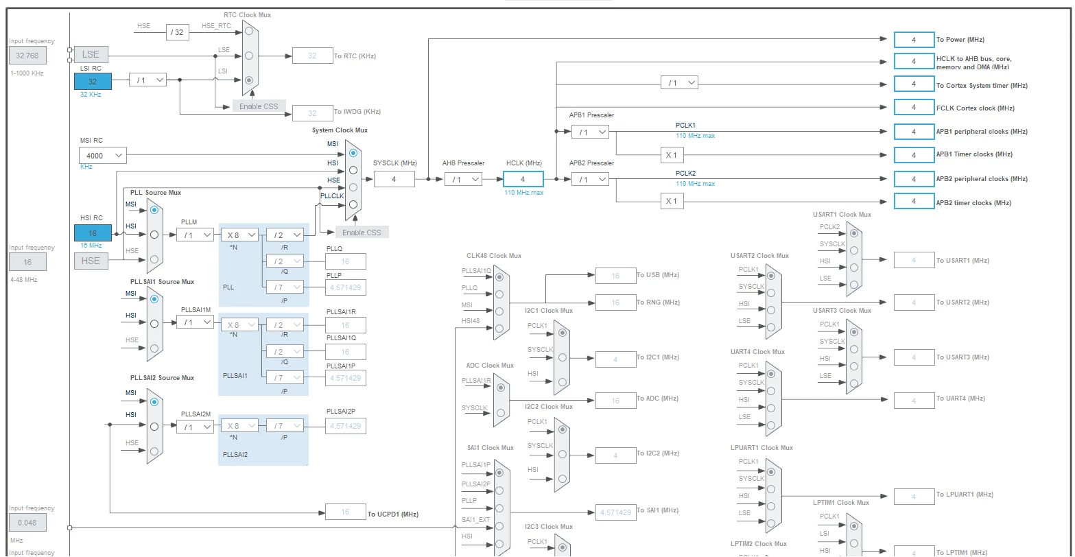

Hello community,
I am working on a STM32L562CETx micro-processor and testing out basic functions. I only use the internal oscillators, no external is connected.
I managed to en-/disable GPIO output pins to drive LEDs etc successfully.
The Problem is:
Using HAL_Delay does not work. It freezes forever, this is because the systick seems not increase. I could not figure out ahy systick is not increasing
Than I changed the timebase to Timer1/Timer4/Timer7/etc. to check if it works with a timer, and the program freezes as soon as it tries to configure the timer as timebase.
After that, I created a completely empty new project, with only the stm32l562ce selected. I have only enabled the Timer4 with internal source.
The program hangs, as soon as I execute the line HAL_TIM_Base_Start_IT(&htim4);
When I step through each line in that particular function, I can step through the whole function, the timer is running (I checked it with live-register view). But after the step-out of the function, any next code line causes a crash. For example: int i = 4; causes a crash as next line.
I checked the following things:
  • correct startup file (yes) - contains TIMER4_ISR Function
  • correct _FLASH and _RAM file (yes)
  • all interrupts enabled
I have no further idea what I can try and desperately seek help.
The code of the program (new project, only timer4 configured) is attached below:

Picture of clock generation (all default values, I changed nothing here). Usually I use max. Frequency and only HSI and LSI.
0693W000005CrmCQAS.pngI would really appreciate any help.
Thanks for your time.

I programmed the exact same project (other processor) on my stm32l562e-dk discovery board (stm32l562QE-Chip), and It worked instantly. Could it be not a software, but a hardware problem? GPIOs etc work but everything with timer/interrupt doesnt.

Nov 27, 2020 1:01 PM UTC
Debug the program. When it hangs, hit pause and determine where it's at. It's possible it's stuck within an IRQ handle due to failing to clear the flag.
MPetr.3
MPetr.3AuthorBest answer
Dec 9, 2020 6:48 PM UTC
I found the problem. I switched the processor on my board and with a new processor it works perfectly. So it seemed to be a hardware fault.
