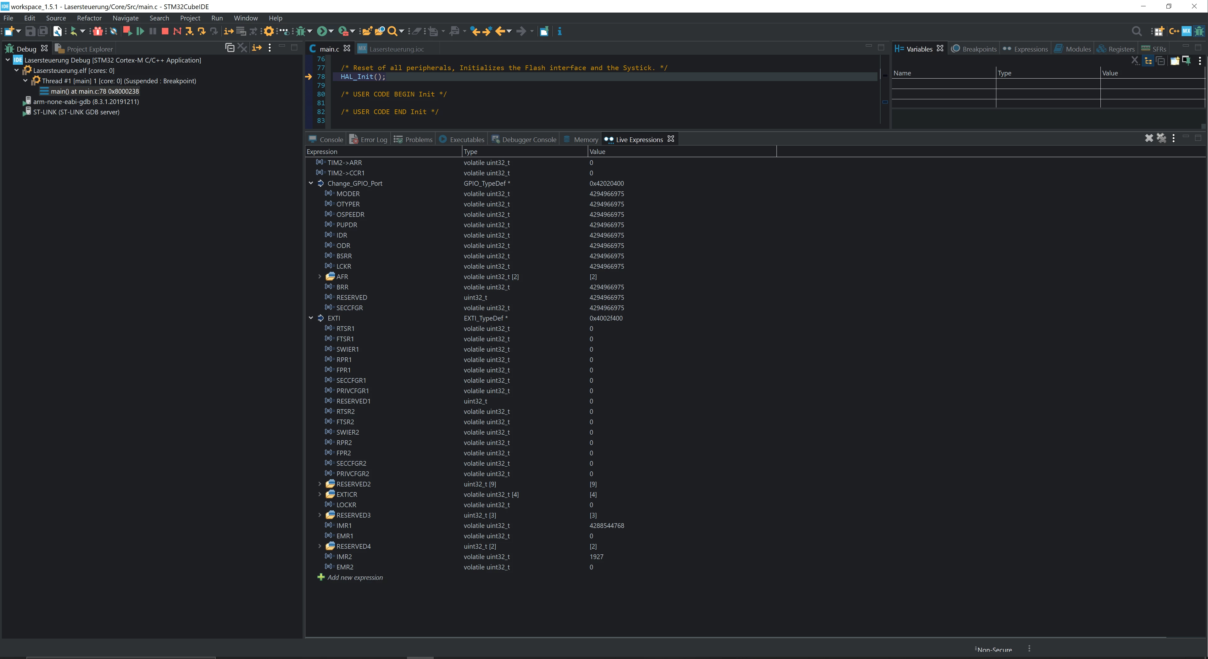

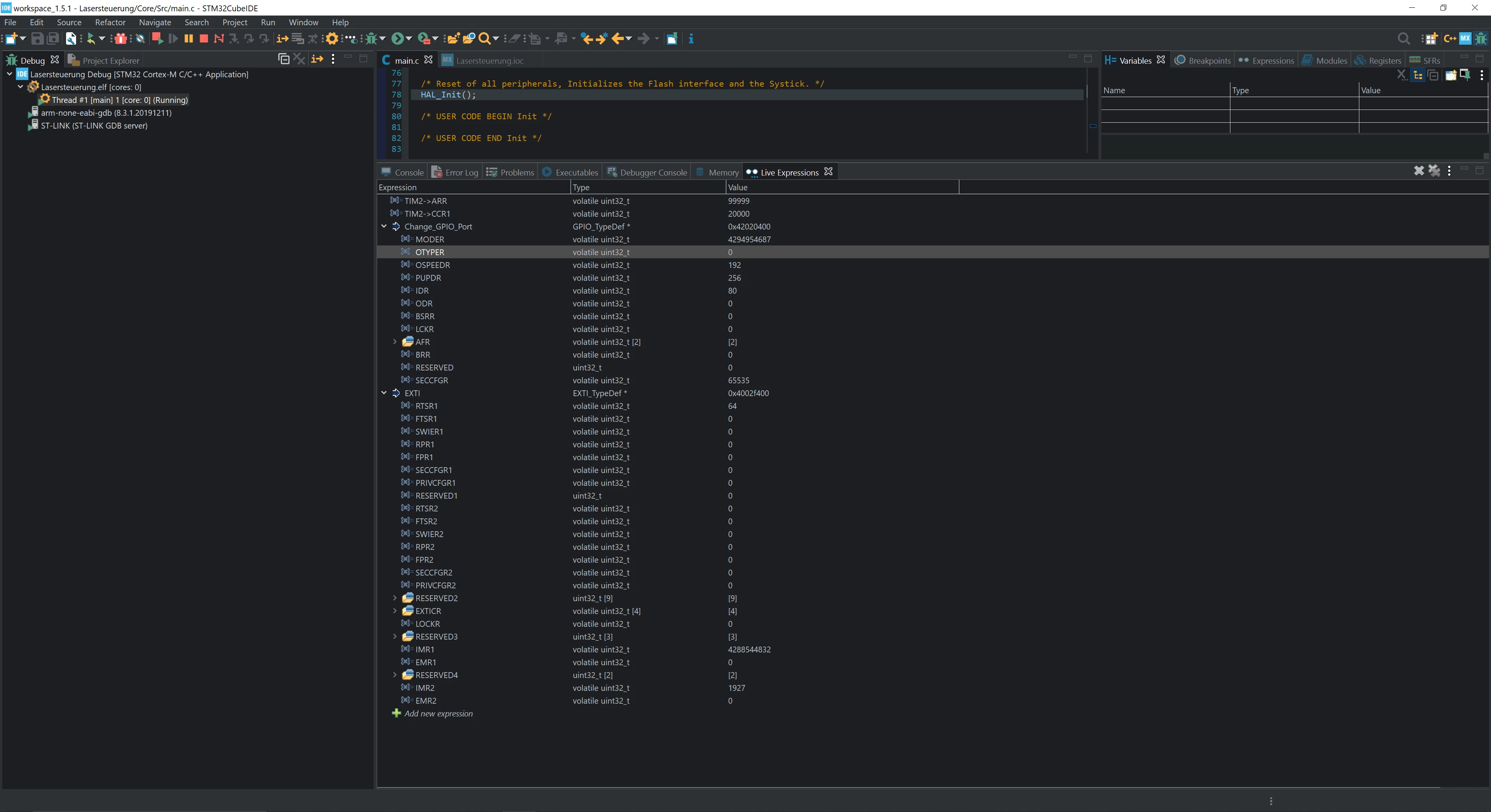

LOlhe.1
LOlhe.1Author
Oct 11, 2021 1:14 PM UTC
I am not quiet sure how to check the linkage of the routines and listing files.
I screenshoted for the other two ideas the Live Expressions before running, while running and while running with 5V connected.
There was no difference between 5V connected or disconnected.
LOlhe.1
LOlhe.1Author
Oct 11, 2021 1:15 PM UTC
Oct 11, 2021 1:41 PM UTC
Look like PB6 is high "before running" as well, so no transition, so no interrupt. What is pulling it down to 0V when the phototransistor is off?

Oct 11, 2021 2:11 PM UTC
And did you measure 0V on the pin?
If IDR reports it as high, and the voltage is 0V, there is a hardware issue. Note that pins are not 5V tolerant if VDD is not present.
