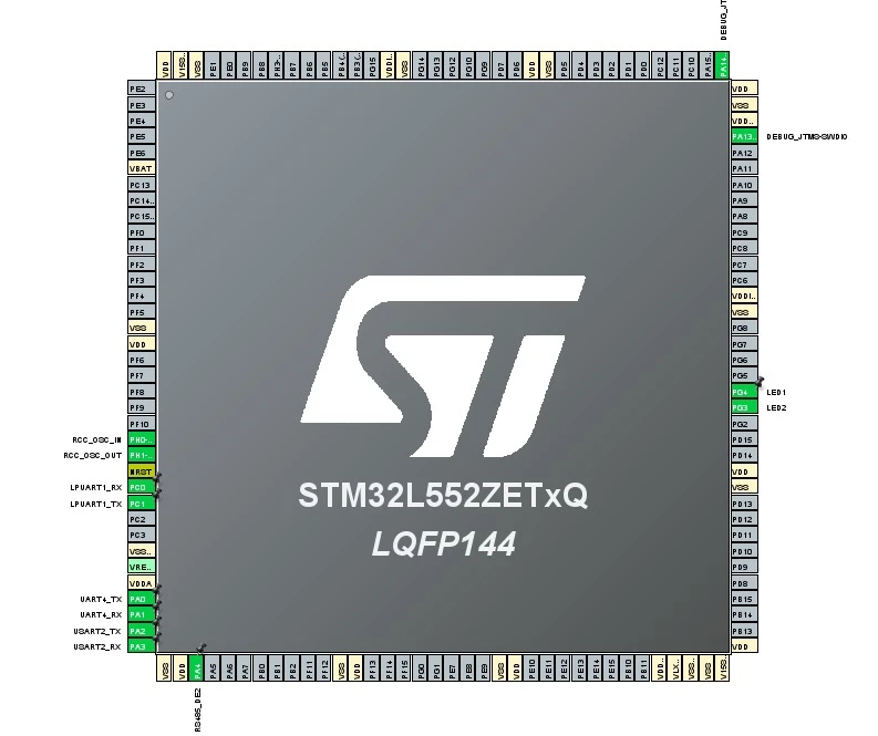

    We are using STM32L552ZET6Q MCU in our project. Here we are using only 3 UART Pheripherals, 2 LED output GPIOs.
    Here We attached the CUBEMX .ioc file of the our project. After the code generation from the STM32CUBEMX, we complete our's own program for the project.
   In this code we are using LPUART1 and USART2 to communicate  a PC for Serial monitoring. UART4 used to Serial communication with another one MCU. Two LED GPIO used to indication purpose.
   After the code completion we flashing the code to the STM32L552ZET6Q  MCU and  it works fine. But most of the time, the controller not working properly, it means the MCU not Communicate with PC and Another one MCU. After the reset Power it will working properly. We cant find whats the problem occure in that time. We doubt this controller may goes to sleep mode or standby mode or shutdown mode maybe. Because the controller was Specially for developed to Low power applications.
  Kindly help us to find issue and resolve it.

Thank you so much for your response.We need to use without wakeup sources. Here we attached our source code of the project. In our code we choose withouttrust zone in CUBEMx configuration ,

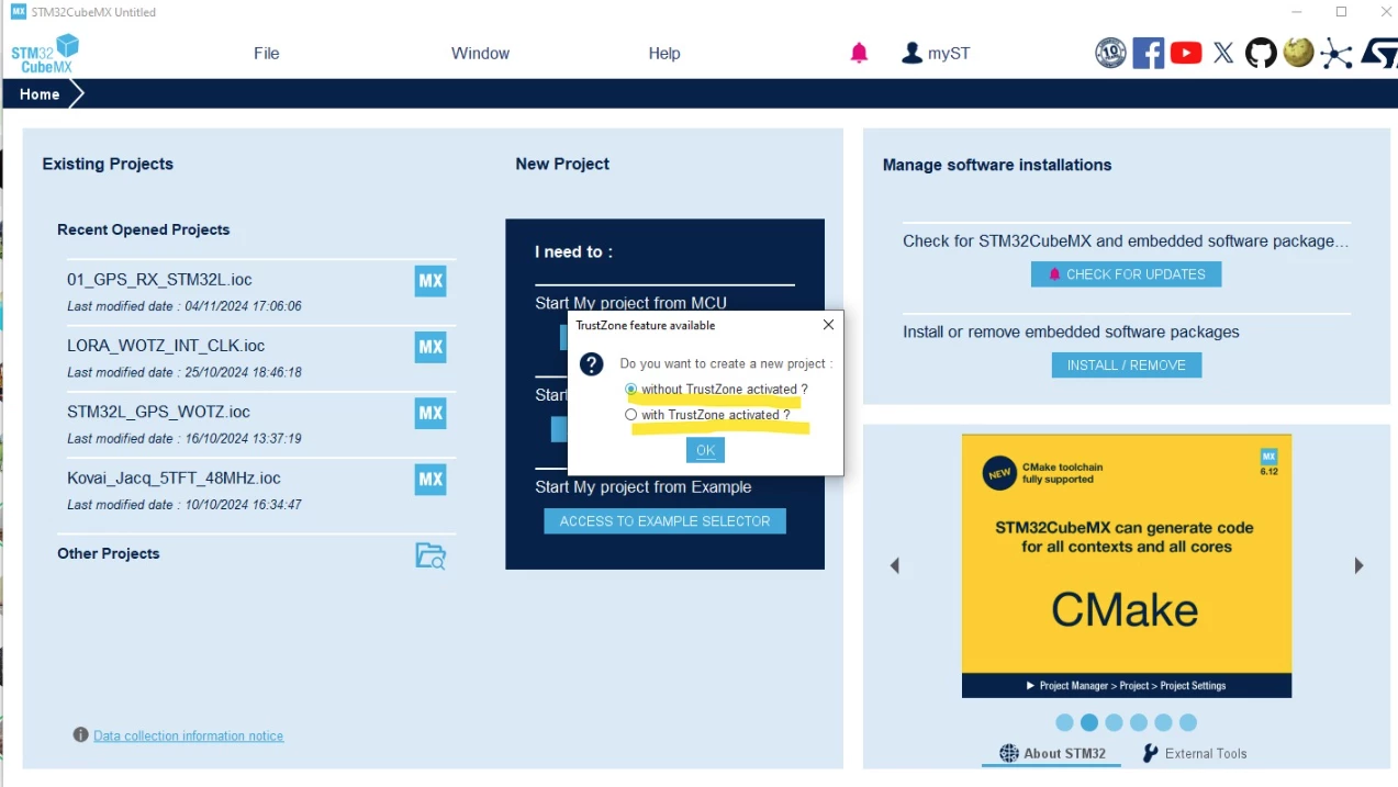

And also we need below clarifications.
1. Whenever we create the new project using STM32L552ZET6Q MCU, the CUBEMX app ask withtrust zone or withouttrust zone. explain this two zones and its applications.
2. And also we have a warnings The insturction cache (ICACHE) must be enabled to reach the maximum performance.The ICACHE can be enabled from the pinout tab under ICACHE.
    After the above mentioned warnings, we selected 1 - way (dirct mapped cache) mode from 1 -way (direct mapped cache)  and 2 -ways set associate cache. explain this two modes.
3. How to use STM32L552ZET6Q MCU without goes to sleep mode or standby mode or shutdown mode. It means its needs to working like a usual MCU.
4. If STM32L552ZET6Q MCU goes to sleep mode or standby mode or shutdown mode, How to properly wakeup the MCU and explain all possiblity cases of this.
