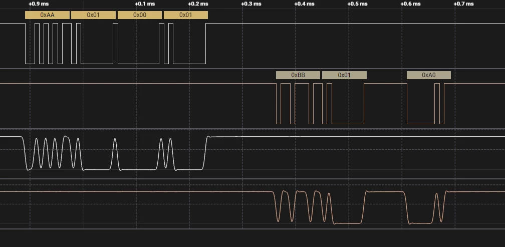

I'm trying to configure and collect data from a BNO055 IMU over UART/RS232, using an STM32L552ZET6Q. The BNO055 is on a remote board, connected via cable to the STM32L5 microcontroller. Additionally, I am using a MAX3232CUE+T on either side of the cable to convert the signal from UART to RS232 and back again.
Unfortunately, I am running into a problem, where when I try to read data from the BNO055, the UART doesn't seem to pick it up. I checked with a logic analyzer and I can confirm that the BNO055 is responding as expected, but the STM32 doesn't seem to realize that anything has arrived. I set the wait time for HAL_UART_RECEIVE to HAL_MAX_DELAY, and it just waits forever.
In the below picture, a request is sent for the BNO055's id (0xA0). This command is composed of a start byte (0xAA), Read or Write (0x01 for read), What is being read (0x00) and how many bytes of data the BNO055 should send back (1, 0x01).
The response back from the BNO055 is success (0xBB), length of the data (0x01) and the data (0xA0).
0693W00000aHLg6QAG.pngI took this capture very close to the STM32 UART GPIO, so I can be reasonably confident that the transmission reached the other side successfully, and the BNO055 successfully interpreted the command and responded appropriately. However, the STM32 doesn't seem to have realized that anything has arrived.

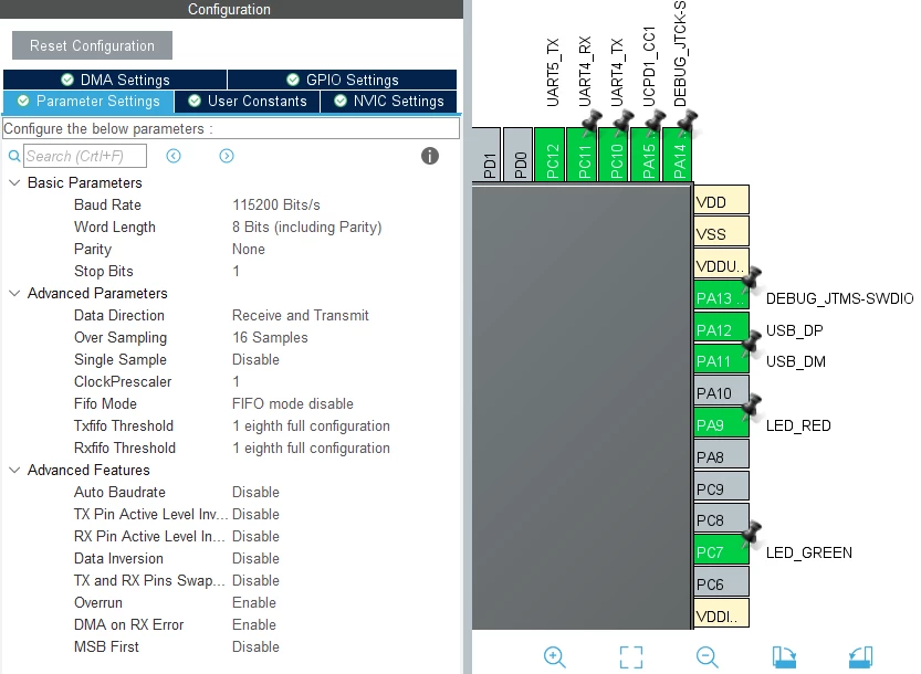

This is the current configuration I have for UART4, which I am using to try to communicate with the BNO055.
0693W00000aHQq6QAG.pngedit: Include datasheet and UART application notes for BN055

Show your code when transmitting and waiting for a response from the device.

Check the pin configurations, at the GPIO
Make sure the UART isn't blocking reception due to a sticky error like noise, parity, etc.
ESpra.1
ESpra.1Author
Senior
February 22, 2023
How would I confirm that?
Tesla DeLorean
Guru
February 22, 2023
I'd use the debugger and inspect the RCC, GPIO and UART registers directly
Errors presumably flagging in UART->SR or iSR
