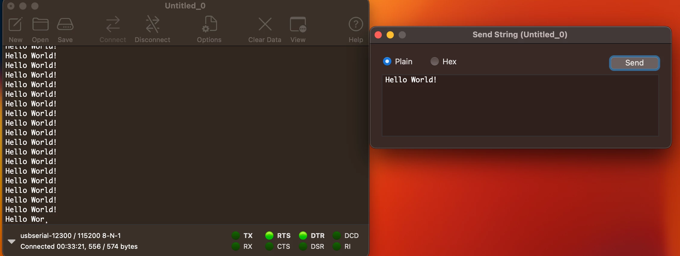

Hi together,
at work I have an Azure RTOS based project with UART communication. The basic implementation of ThreadX is working fine for toggling LEDs, but I need to do some SPI communication to an ePaper display and communicate with the MCU over UART.
So I created two separate threads, one for the UART and one for SPI. The display thread is only doing some stuff when there is new data received over UART or we have a time depended change of the shown information.
The problem is that the UART communication stops working after I received some strings. I created a basic example project that just doing UART stuff, it resends the received bytes.
UART reception is handled via DMA and starts with HAL_UARTEx_ReceiveToIdle_DMA in the thread initialization.
After some bytes are sent fast from my Mac to the board the retransmission is not working and the whole communication stops.
My main() is doing the initialization of the peripherals and everything else is working in the thread and the interrupts:

The problem occurs earlier if I have not connected the debugger to the board.
Hope anyone has a suggestion to solve this?!

I reduced the UART RX interrupt, but this doesn't help a lot.
void HAL_UARTEx_RxEventCallback(UART_HandleTypeDef *huart, uint16_t Size)
 HAL_UART_RxEventTypeTypeDef rxEvent = HAL_UARTEx_GetRxEventType(huart);
 if (rxEvent == HAL_UART_RXEVENT_IDLE)
 // update buffer index
 uart_rx_buffer.stopIndex = Size;
 // resent received bytes (for debugging)
 if (uart_rx_buffer.stopIndex >= uart_rx_buffer.startIndex)
 	uart_tx_add_message(&uart_rx_buffer.buffer[uart_rx_buffer.startIndex], uart_rx_buffer.stopIndex - uart_rx_buffer.startIndex);
	else
		uart_tx_add_message(&uart_rx_buffer.buffer[uart_rx_buffer.startIndex], uart_rx_buffer.bufferLen - uart_rx_buffer.startIndex);
		uart_tx_add_message(&uart_rx_buffer.buffer[0], uart_rx_buffer.stopIndex);
 uart_rx_buffer.startIndex = uart_rx_buffer.stopIndex;
 After some amount of bytes it stops receiving. It feels like it happens when a transmission is ongoing and then the RX interrupt is called. But the transmission is also handled via DMA transfer, so in my opinion it should work.

I made some changes to the HAL_UART_ErrorCallback() function to provide more information after I got a message from the callback.

After getting the message "ERROR: 2" in the terminal I figured out a NOISE ERROR. If any error occurs now I re-initialize the peripheral and restart the reception over DMA inside my thread.

To reduce the noise on the communication lines I connect the GND from the FTDI Quad UART adapter (build on my own) with the GND of the PCB / power supply. Now it seems to work.
Has anyone another solution to handle errors instead of a full re-init of the peripheral? Maybe I can just flush the buffers and clear the error flag?
