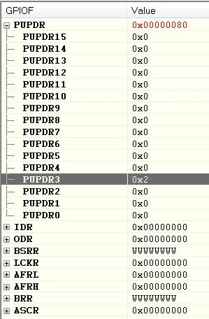

We are using PF3 for one of our output function and we need to pull that pin down internally. So we are configuring that pin as output enabling clock etc and using LL driver "LL_GPIO_SetPinPull" function with port and pin with argument "LL_GPIO_PULL_DOWN" to enable internal pull down. Also we can see the Register PUPDR3 getting configured properly after that in the Register window.
So it will be really helpful if anyone could confirm that this is the way to enable internal pull down for a pin, or is there any other register that we need to set.
