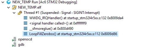

STM32L4R5ZI reset issue.
Posted on May 31, 2018 at 15:48
Archive addition leading to Reset.
Now its failing in SystemClock_Config.
And entering to WWDG_IRQHandler() at startup_stm32l4r5xx.s:132 0x8009dc0
Failing at
♯♯♯♯♯♯♯♯♯♯♯♯♯♯♯♯♯♯♯♯♯♯♯&sharpin Debug After completing the above 2 lines enter to reset♯♯♯♯♯♯♯♯♯
---->>>>>>>>>>>/* Enable voltage range 1 boost mode for frequency above 80 Mhz */
__HAL_RCC_PWR_CLK_ENABLE();
HAL_PWREx_ControlVoltageScaling(PWR_REGULATOR_VOLTAGE_SCALE1_BOOST);
__HAL_RCC_PWR_CLK_DISABLE();

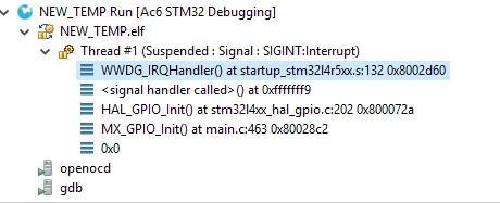

    Phanirajkiran M
    Senior
    Jun 1, 2018 8:21 AM UTC
    Posted on June 01, 2018 at 08:21
    Thanks for the support.
    I have taken the systemconfig from the sample code provided from L4 Software Stack bundle.
    But now when i apply this code what you have provided.
    Now its clear that the stack before entering the RESET / WDT.
    It looks like this
    From GPIO its picking.
    May i post some more info after debugging.
    Thanks
    Phani

    Phanirajkiran M
    Senior
    Jun 1, 2018 6:39 AM UTC
    Posted on June 01, 2018 at 08:39
    Dear Clive,
    I have no WDT set and No TIM set.
    When i start debugging and try to see closely in single step from Main()
    when i use RCC_OSCILLATORTYPE_MSI
    When i use HSE it enters to a RESET and not ready stage.
    may be the lib is not compatible to the system when integrated.
    But my doubt is irrespective of lib it has to pass the systemconfig function call.
    Thanks for support.
    Thanks
    Phani
