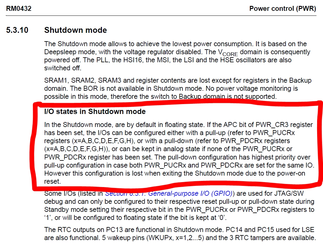

STM32L4R5QII6 Control of GPIOs in Shutdown mode
Hi
For STM32L4R5QII6 is there any way that we can control GPIO i.e., PF15 pin when the MCU is in Shutdown state. Do we need to have any pull-up for those GPIOs which need to be controlled?
TDKBest answer
Sep 16, 2020 1:40 PM UTC
From the reference manual:
1 reply
TDKBest answer
