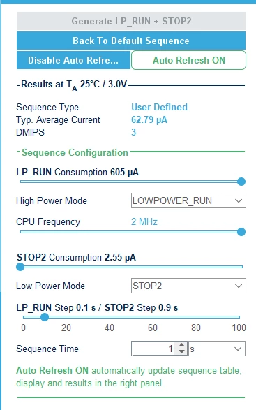

Hello STM32-Community,

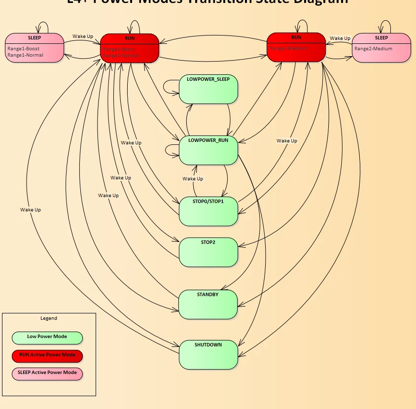

I'm getting mixed results checking up this question. In the power consumption calculator (PCC) there is the following diagram displayed:0693W00000JOq99QAD.pngAs you can see it should not be possible to enter STOP2 from LOWPOWER_RUN. However the sequence generator allows me to use it, even though its red underlined in the sequences:
Therefore I wanted to ask, is it possible to enter the STOP2 mode from low power run? And if not, why? I couldn't find an answer to the low-power manual from STM32, as well as the reference manual.

Hello @crackl1ng​ ,
Yes you are right. It's not possible to make the transition from LOWPOWER_RUN to STOP2. It's mandatory to pass through the RUN MODE.

Thank you for your reply.
As it seems it is also not possible to return to LOWPOWER_RUN from STOP1. I've tested it out, but the SystemClock jumps back to 48 MHz. Are there different STOP1-Modes?

Hello @crackl1ng​
It could be possible to return in LOWPOWER RUN from stop1. Make sure to have STOPWUCK=0 (register RCC_CFGR) and LPR=1 (RCC_CFGR).
Let me know if it's working.
