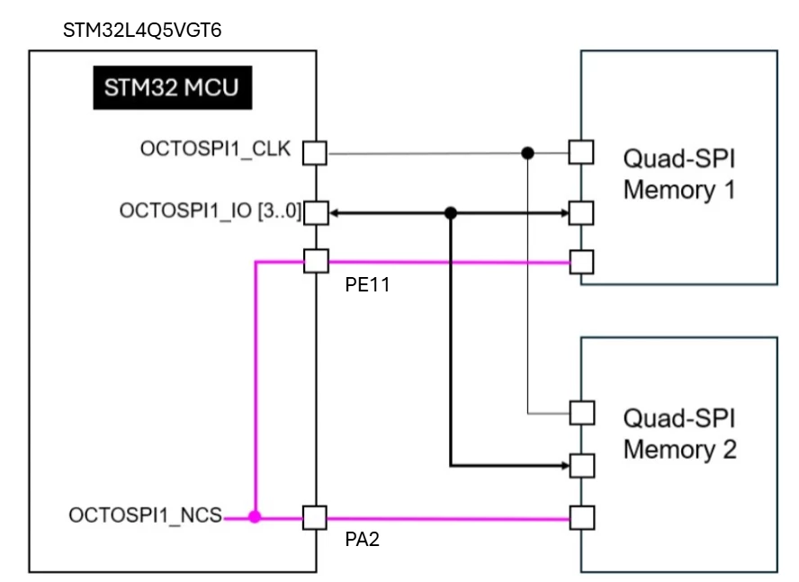

I am using STM32L4Q5VGT6 I need to use 2xQuad SPI memory. I need a confirmation whether we can use OCTOSPIM_P1_NCS pin from PE11 & PA2 CS-pin as individual cs pin for both Quad memory chip.

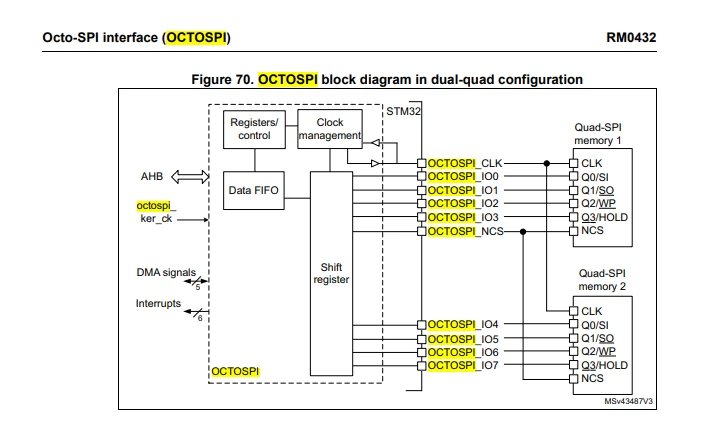

Yes, it is possible. Please see the RM0432 for more details:

Hi ​@Saket_Om ,
