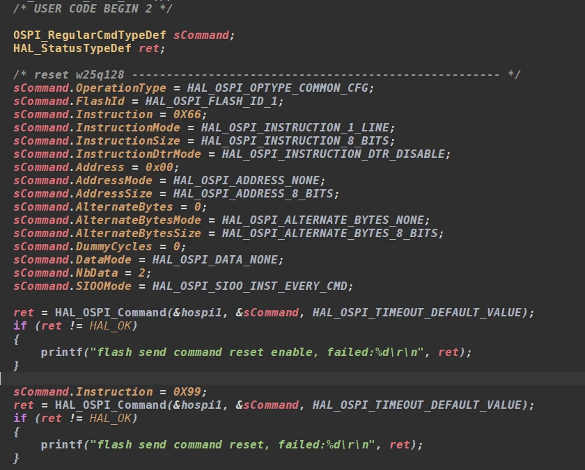

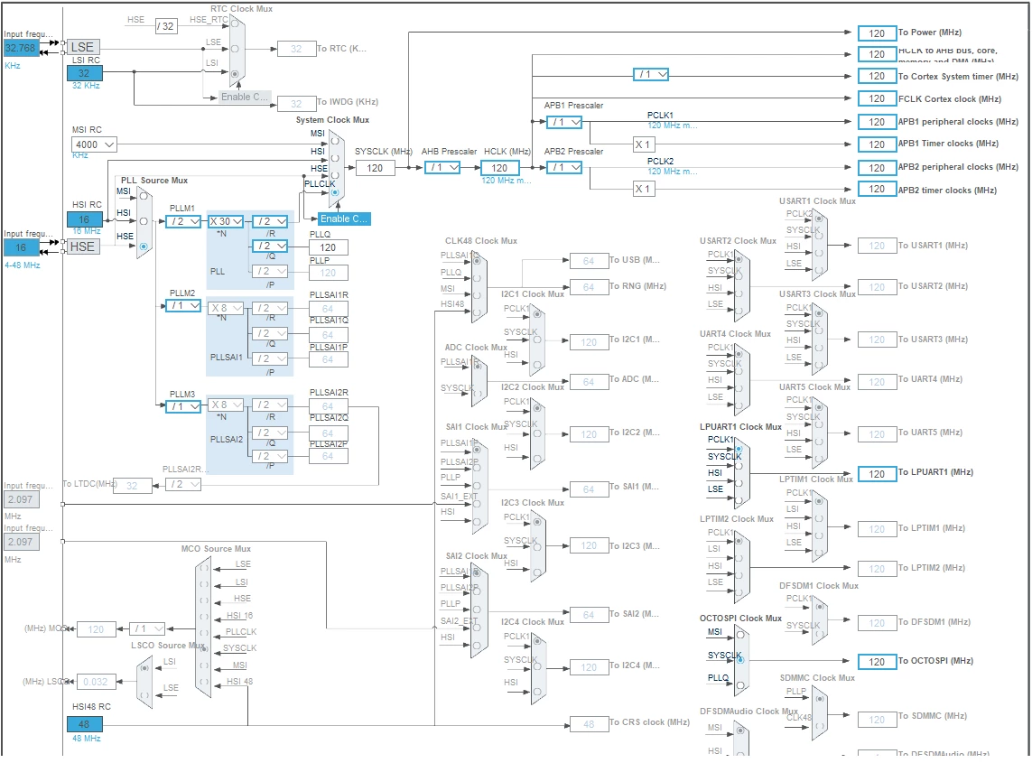

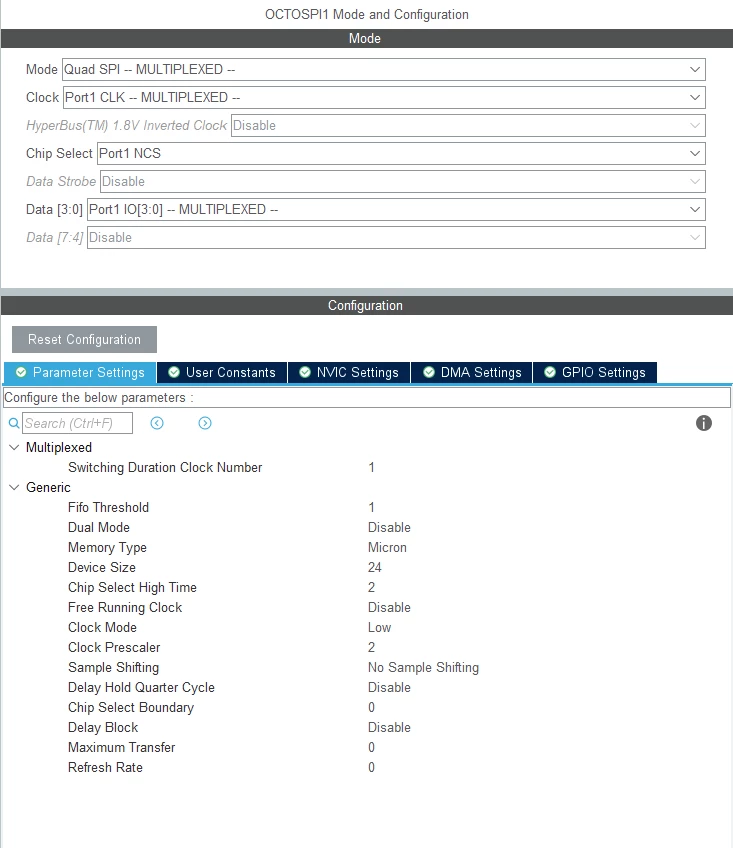

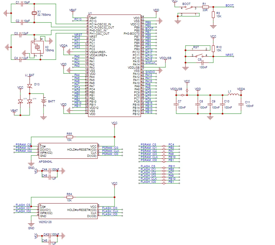

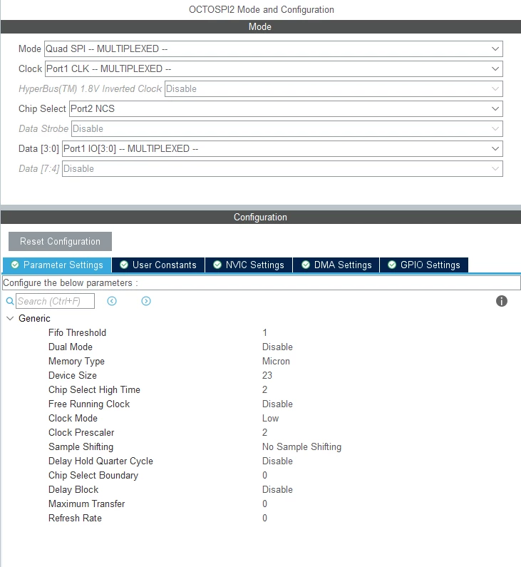

Hi :
I have a custom board, the mcu is STM32L4P5RG, I also connect Flash W25Q128(OSPI1) and APS6404L(OSPI2) to it.
But I can't reset them and hal status always return HAL_ERROR. Can someone help me?
The hardware schematic(Sch.png),Clock configuration(Clock.png),OSPI configuration(OSPI1.png, OSPI2.png),Reset code(Code.png)  are as below:
I also attach my project.

Hi :
Finally, I can reset both OSPI device. It need send more data to ensure reset successfully. Just change HAL_OSPI_ADDRESS_NONE to HAL_OSPI_ADDRESS_1_LINE will fix this.
I think it is something related to Errata sheets.

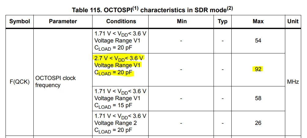

KDJEM.1
May 14, 2024

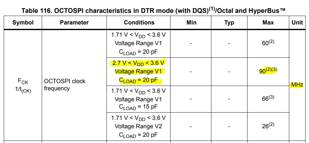

Hi @Zhou JianQiang ,
Could you please try to decrease the OCTOSPI clock frequency.
As mentioned in STM32L4P5 datasheet Table 115. OCTOSPI(1) characteristics in SDR mode(2) and Table 116. OCTOSPI characteristics in DTR mode (with DQS)(1)/Octal and HyperBus™, the maximum clocks frequencies of OCTOSPI are 92 MHz in SDR mode and 90 MHz in DTR mode.
Thank you.
Kaouthar
Zhou JianQiang
Senior
May 15, 2024
Hi @KDJEM.1
I have set Clock Prescaler to 2, Do you mean it doesn't enough, I have to set OCTOSPI clock from 120Mhz to 90Mhz?

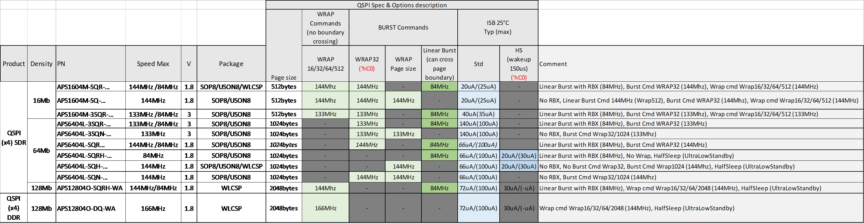

Let me add few comments, I hope this helps.
Attached file for QSPI SDR & STM32L4P5 (tested on STM Disco)
Regarding QSPI device there are a couple of options possible which is not visible in the root PN APS6404L on your schematics, such as 1.8V/3V, RBX, Halfsleep ( PN such as APS6404L-3SQR / 3SQN / SQR / SQRH / SQH / SQN). For example RBX device ("SQR...") can burst only up to 84MHz, while WRAP can run up to max frequency.
For your reference,  see below an overview of different QSPI SDR/DDR options available (voltage, function, frequency, power, and type of package)
Datasheet available at https://www.apmemory.com/products/psram-iot-ram/
QSPI Prototyping at https://www.mouser.com/c/semiconductors/memory-ics/dram/?m=AP%20Memory%20Technology&package%20%2F%20case=SOP-8~~USON-8%7C~WLCSP-15%7C~WLCSP-8&rp=semiconductors%2Fmemory-ics%2Fdram%7C~Package%20%2F%20Case
Regards
Alex

Alex - APMemory
May 17, 2024
Good, for APS6404L-3SQR.you can use the WRAP32 command up to 133MHz and linear burst (with RBX) up to 84MHz.
Spec link:  http://www.apmemory.com/wp-content/uploads/APM_PSRAM_E3_QSPI_APS6404L-3SQR-v2.6-KGD_PKG.pdf
Hope all goes well
Alex

Hi :
