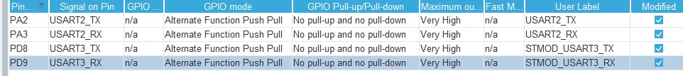

Greetings,
I have STM32Cube IDE installed, created some test apps, blinking LED's, RTOS threads, mutex and so on,
writing on UART2 (virtual serial) is working well as I have working output on virtual COM port using putty on serial.
I want to access UART3 as I have ESP-01S board connected on CN4 but no success.
For the test I have removed ESP-01S and connected USB-RS232 (3.3V) RX/TX pins on CN4, opened another putty on this serial port to see output but whatever I send to it, nothing happens on putty.
In test thread I'm doing this:
void WifiTask(void const * argument)
 uint8_t buffer[64]={0};
 int len;
 for(;;)
 len = sprintf((char *)buffer, "AT+GMR\x0d\x0a");
 HAL_UART_Transmit(&huart3, buffer, len, HAL_MAX_DELAY);
 osDelay(100);
But nothing comes out. I have changed all possible combinations of GPIO mode and GPIO Pull up/dn, but serial port is silent as hill.
Is there any hint on what should I do to proper initialize this USART3 port?
As I said, USART2 is working as it should but seen on PC as virtual COM port trough USB connected Dev board.

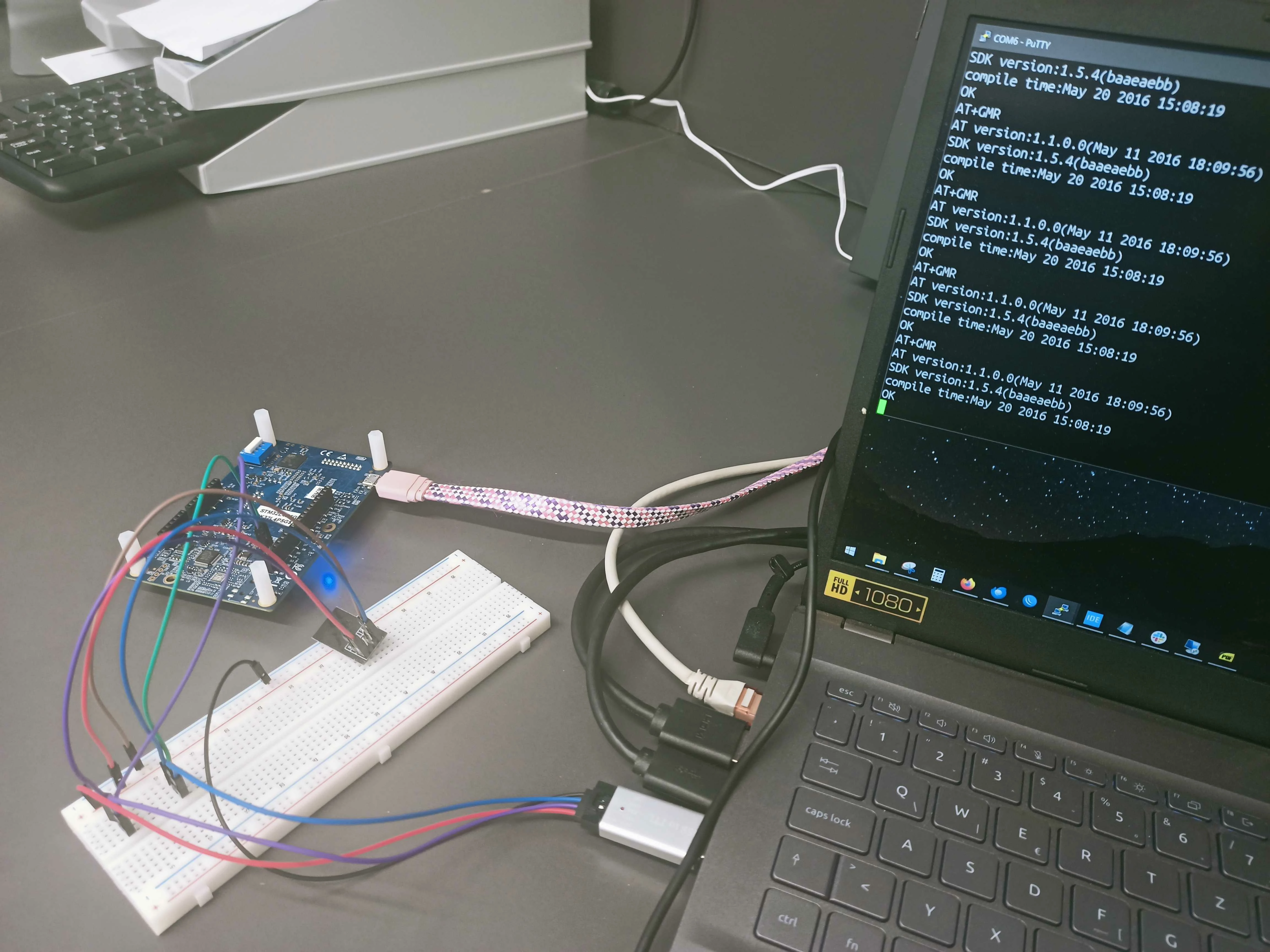

Greetings, here are the updates:
I've switched from USART3 (on STMod+ daughter board) to the LPUART1 (onboard CN14 D0/D1) and set up to 1152008N1 and it worked.
I've even connected USB-RS232 on the same TX/RX lines so I can spy what STM32L4..DK and WRL-17146 are talking together.
So the question stays the same, why USART3 on STMod+ is not working, and what shell I do to make it working as on this daughter board is dedicated port for ESP-01S and fits perfectly.
Here's the image of testing environment.
In the WifiTask thread I'm initializing the ESP01S with AT-RST -> reset and ATE1 -> more details
and in the loop AT+GMR -> get firmware info and as shown it's working.

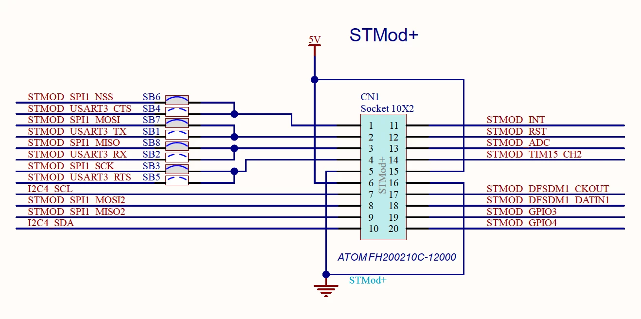

Hello @RobertGrizilo
Did you check STM32L4P5G-DK schematic in page 12
https://www.st.com/resource/en/schematic_pack/mb1535-l4p5g-b02-schematic.pdf
STMOD+ CN1 (below) is hardware configured in SPI mode on pin 1 to 4 (NSS, MOSI, MISO & SCK) by SB3 to SB6.
You should:
Open SB7, solder SB1 to wire STMOD_USART3_TX.
Open SB8, solder SB2 to wire STMOD_USART3_RX
Let me know ?

Thanks, that make sense.
I was looking in the STM32L4P5-IO.pdf and STM32L4P5-DK.pdf manuals and there is no mention that the board default to SPI.
I saw STmod+ CN1 connector and CN4 connector which said it's for ESP-01S WiFi board so I assumed it's in normal RS232
Ok, I will not modify the board as I don't wan to have is modified and LPUART1 is working fine.
Thanks, It would be nice to have this info in the manual, It would reduce head scratches.
