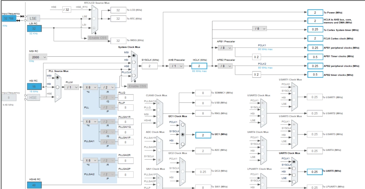

I have also attached my clock configuration as follows.
Appreciate any advise on what I am doing wrong. Thank you.

Hello Sarra, thank you for the reply.
Initially thought I had to use a different flag as it was UART5 instead of USART5 on STML4A6.
Either way, I have tried the code as recommmended but was still unable to wake up from stop mode.

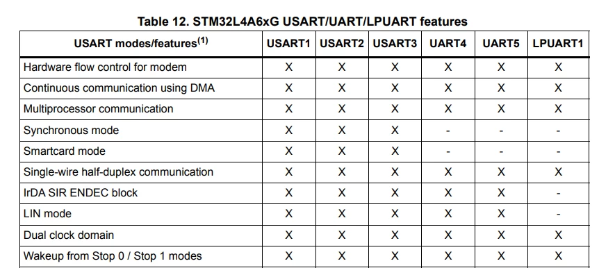

In the datasheet, UART 5 is able to wake stop1, so i believe that it should be possible

jlsw30AuthorBest answer
September 20, 2024
Solved this by adjusting clock to not use MSI, though this is not an optimal solution as i would prefer a lower clock speed configuration for my usage. Will try to see how i can modify the code to work with MSI clock configuration.
