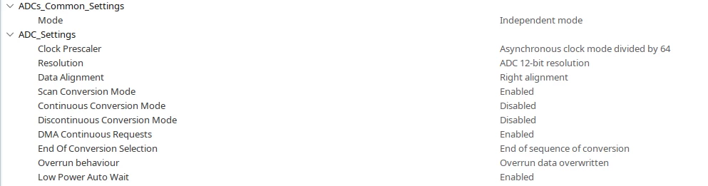

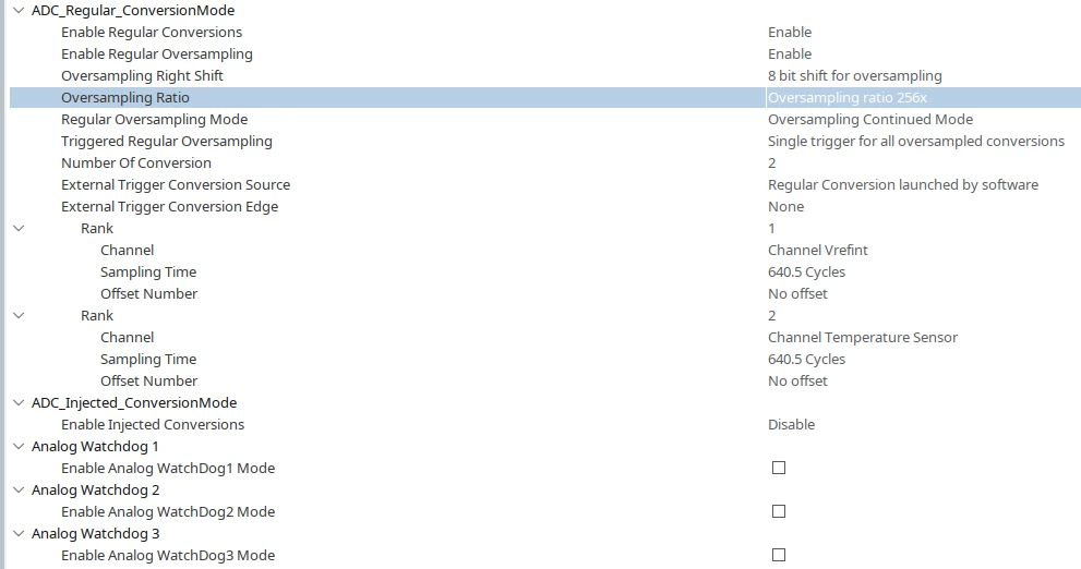

I'm using ADC1 to measure the Temperature Sensor channel and the Vrefint channel. I expect those to vary very slowly and I am in not in a hurry so I am maximizing the sampling time. These are my settings in STM32CubeIDE:
It generates the following in main.c:
static void MX_ADC1_Init(void)
 /* USER CODE BEGIN ADC1_Init 0 */

The ADC clock is set to PLLSAI1R, and
 printf("ADC1 clock freq.: %lu\n", HAL_RCCEx_GetPeriphCLKFreq(RCC_PERIPHCLK_ADC));
prints "ADC1 clock freq.: 48000000".
EDIT: ADC_CCR is
 // 3 2 1
 // 10987654321098765432109876543210
 0b111001000000000000000000
Bits 21:18 PRESC[3:0]: ADC prescaler: 1001: input ADC clock divided by 64
My theory is that a sequence of conversions should take about 446 milliseconds:
  • (640.5 + 12.5) cycles per channel sample,
  • 2 * (640.5 + 12.5) for two channels,
  • 256 * 2 * (640.5 + 12.5) for 256x oversampling
  • = 334336 cycles
  • fADC_CLK = 48E6 / divADC_CLK
  • = 48E6 / 64 = 750000
  • 334336 cycles * (1/fADC_CLK) = 334336 / 750000
  • = 445,781 us
However, when I run this:
 LL_ADC_ClearFlag_EOS(ADC1);
 __COMPILER_BARRIER();
 start = micros();
 LL_ADC_REG_StartConversion(ADC1);
 while(!LL_ADC_IsActiveFlag_EOS(ADC1) && micros() - start < 1000000);
 assert(LL_ADC_IsActiveFlag_EOS(ADC1));
 printf("EOS wait: %lu us\n", micros() - start);
I consistently see "EOS wait: 1757 us". That is a couple of orders of magnitude less time than I was expecting.
What am I missing?

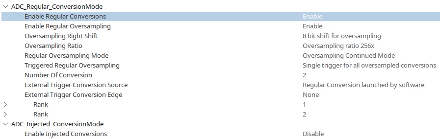

Best answer by CKugl.1
I see it now. Even though I selected Enable Regular Conversions: Enable in STM32CubeIDE:
that, apparently, doesn't do anything. It's up to the user to manually set
Bit 0 ROVSE: Regular Oversampling Enable
This bit is set and cleared by software to enable regular oversampling.
0: Regular Oversampling disabled
1: Regular Oversampling enabled
I added
 ADC1->CFGR2 |= ADC_CFGR2_ROVSE_Msk;
to my initialization function and now I am getting "EOS wait: 445799 us", which is what I expected in the first place.
I added
