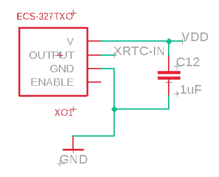

I'm using a TCXO as the input for the RTC on LSE.  The particular TCXO is ECS-327TXO-2012-33-TR.
Here is the weird thing.  If the board is inside a building, my house in this case, all is good, the RTC starts up no problem.   However, if the board is outside (it's a weather instrument so it will operate outside on battery power), the RTC fails to start up, with a timeout inside RTC_EnterInitMode.
If I run the RTC on LSI then all is fine, but I need more accuracy, thus the TCXO.
Below are details on the setup.  If any further information is required let me know.
Any help would be greatly appreciated!  This one really has me stumped.
Jerry
The circuit diagram for the TCXO is:
Where XRTC-IN is connected to pin 3 (PC14-OSC32-IN) of a STM32L496RGT3.

try : enable -> hi , connected to VDD.
Maybe the internal pullup is very high impedance, so even some moisture is enough to stop it working.

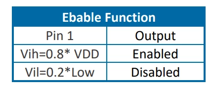

ds of other ECS-327 series shows :
So : better enable -> VDD .
7 replies

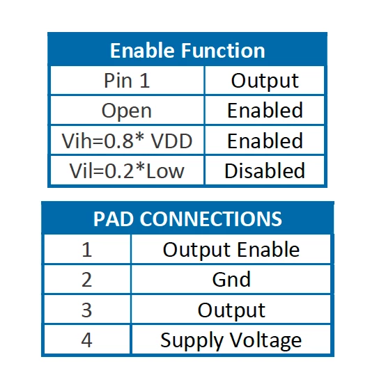

As per the TCXO data sheet, if the enable is left open it should be enabled.
AScha.3
