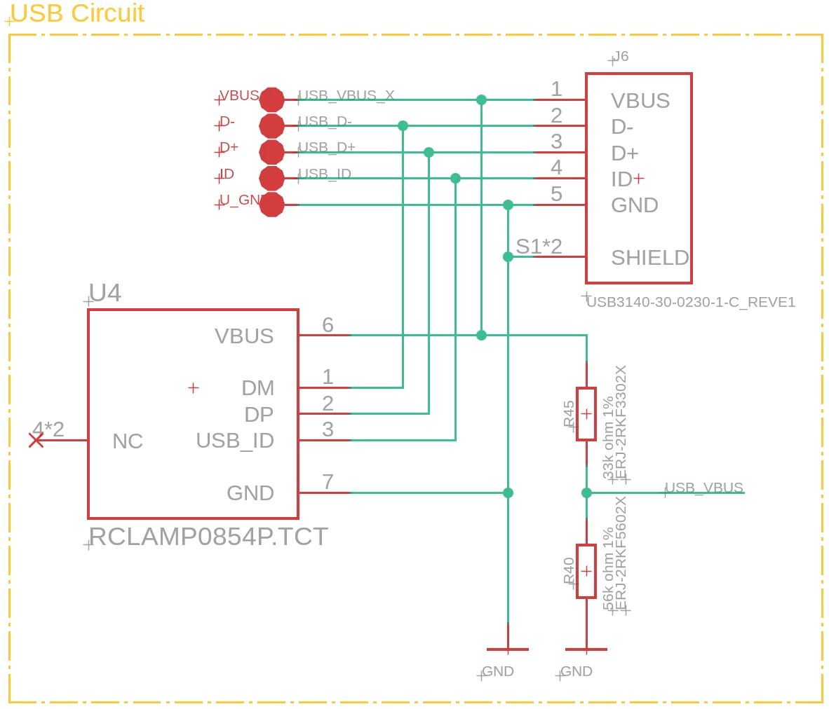

Hello. I am working on a project that uses a STM32L496VET6 microcontroller and that can work as an USB device. The board has the following usb circuit schematic:
The USB signals are connected directly to the MCU (D+ to PA12, D- to PA11, ID to PA10 and VBUS to PA9). The board is self-powered, so the USB power is not used. The VBUS goes through a voltage divider to reduce the voltage from 5V to approximately 3.14V. I configured the peripheral to work only as a device and the interruptions are also enabled. The middleware is configured to use the USB as a COM port.

Mailson97Best answer
Mar 17, 2025 1:25 PM UTC
I found out the problem. I was checking the PCB design of the prototype and I noticed that the VDDUSB pin was not connected. I connected the pin to VDD and the board now is being detected by the computer.

Mailson97AuthorBest answer
