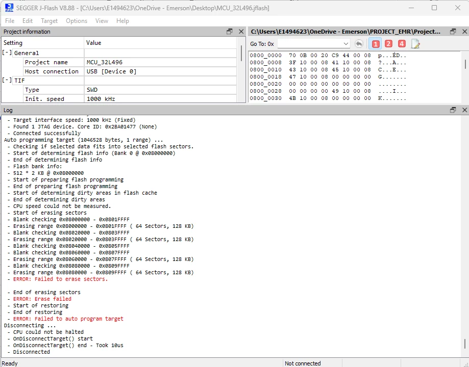

We have observation that STM32L496RGT6 takes around 32mA current when not even flashed first time. That is STM32 has purchased from supplier and assembled only. It takes 32mA.
When it is first time programmed when it takes less current.
What could be reason and how to solve first problem.

what kind of programmer is used?Any error log?
Sep 3, 2026 9:48 AM UTC
We are using Segger Flasher.
MCU draws more current around 13.5mA continuous at 1.8V. We have 11mA at 1.8V.
Sep 4, 2026 9:09 AM UTC
While flashing MCU, it is observed that PB9, PB10 sink some current as we have some circuit connected which draws current from same net of MCU(1.8V). Why these pins not in high impedance or high while programming.
Or we need to check for another pins?
