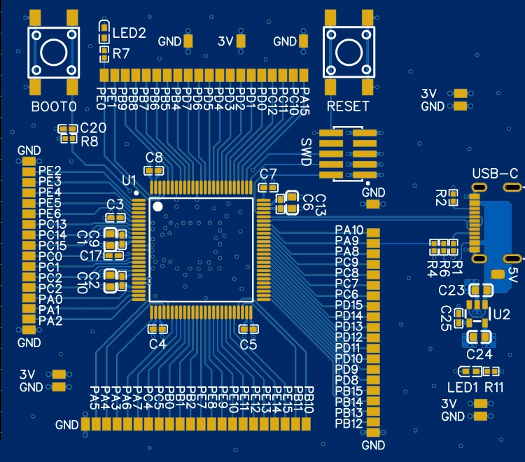

To map the MCU ports, I’ve fabricated this PCB:
The PCB includes the following components:
  • 3V power supply
  • USB FS interface
  • SWD, Reset, and BOOT0 pins
  • 12MHz HSE crystal
All other ports are connected to test pads, as shown in the design.

waclawek.jan
waclawek.janBest answer
Dec 7, 2024 8:21 PM UTC
Sorry I overlooked that AN2606 says indeed that PA9 and PA10 are without the pullup.
4 replies
waclawek.jan
Dec 7, 2024 1:59 PM UTC
You probably have bootloader v9 - that's described further on in AN2606.
AN2606 also says, that bootloader v10 is in 'L476/486 rev.3 and bootloader v9 is in rev.4. Don't ask me, why...
What you see in most cases is a pin not being pulled hard up, but only through the internal nominally 40kOhm pullup. Exceptions are probably the SPIx_MOSI pins, PA6 and PB14, which are probably pulled hard. PB8/PB9 is for CAN.
