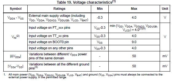

Is it a problem when the ADC input voltage is above the reference voltage? I know that some ADC's can get damaged in this case. In the datasheet I found that
- GPIO VIN max = 4V (STM32L476xx Datasheet, DocID025976 Rev 3, Table 18)
- This absolute maximum rating I would fulfill

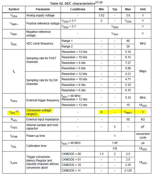

- ADC VAIN Conversion voltage range max = VREF+ (STM32L476xx Datasheet, DocID025976 Rev 3, Table 62)
- This looks like it is just where the ADC converts but not like a do-not-exceed limit
So if the ADC in this configuration can get damaged by a 3V voltage I would look for some alternative (other reference, limit input signal externally) but it would be the best if it could withstand it.
