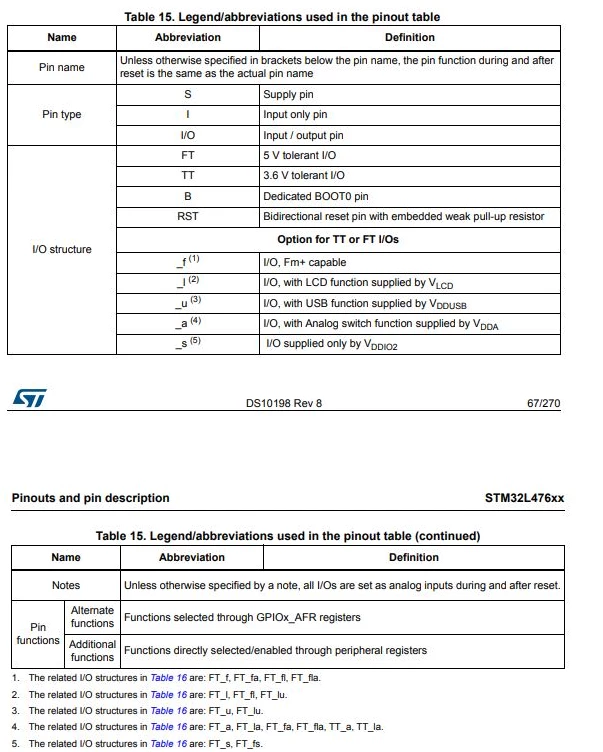

STM32L476RGT which are the 5V tolerant pins? Where can I find these infomation in data sheet?
Hello, I use for STM32 (1.8V VDD) SPI communication with an slave temperature Sensor (3.5V basic voltage, detects high at 0,7*3,5V)
SCLK =PC10
SDO = PC11
SDI= PC12
CS = PC13
For that reason I want to use an external 3.5V Pullup. But I'm not sure if this is OK for pins
PC10/PC11/PC12/PC13. Can anybody tell me if this is OK?And where I can find these information in datasheet? I already looked in the AN4899 Application note, but coulkdn't find which pins are 5V tolerant. In special if PC10/11/12/13 are 5V tolerant.

Hello @FHopp.1​
You can refer to the STM32L476xx datasheet, and see the tables:
  • Table 15: Legend/abbreviations used in the pinout table
  • Table 16: STM32L476xx pin definitions table 0693W000006G18vQAC.png
