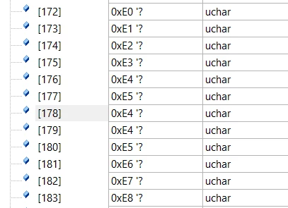

stm32L476RG SPI read data from FRAM occurred error .

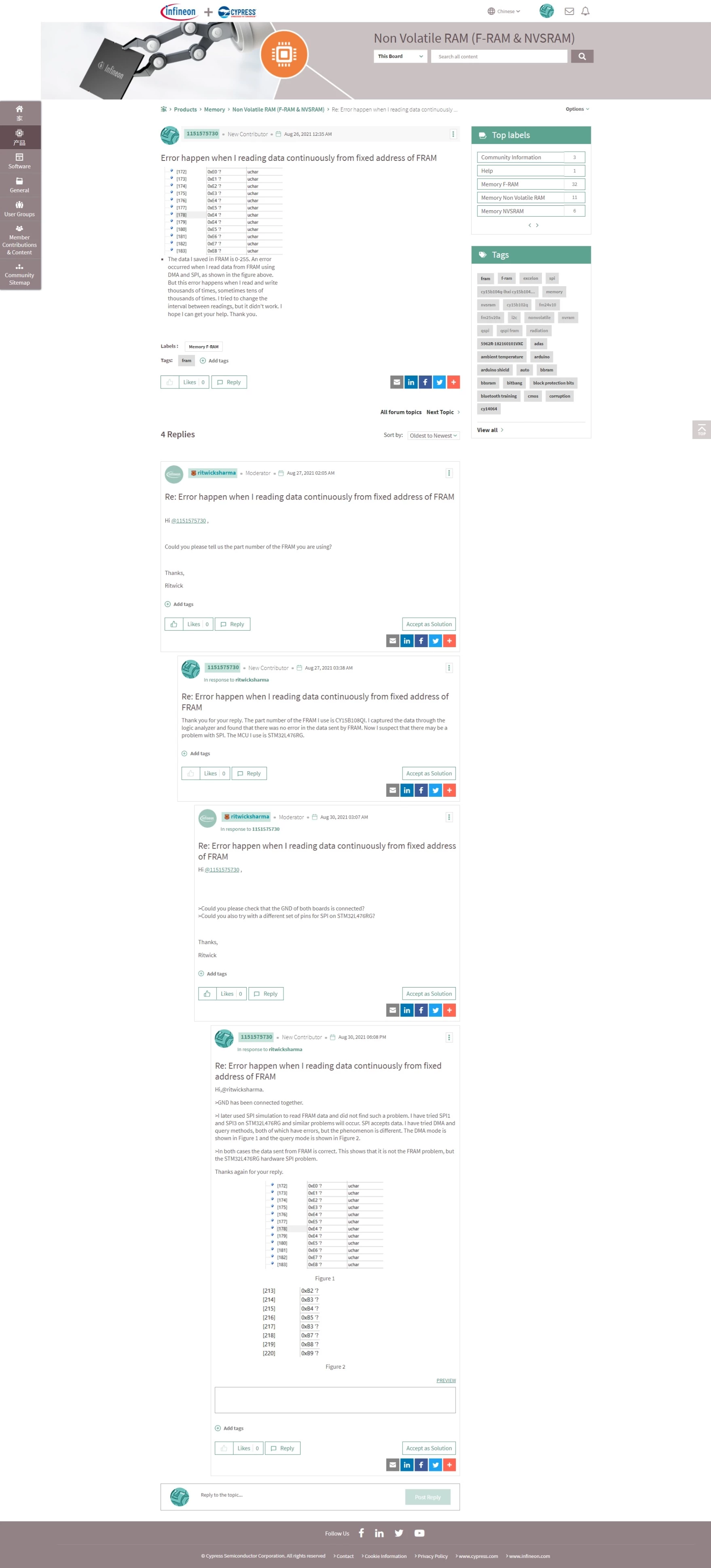

The FRAM chip I'm using is cypress.For details, here's a screenshot of my chat with Cypress.Thank you very much.

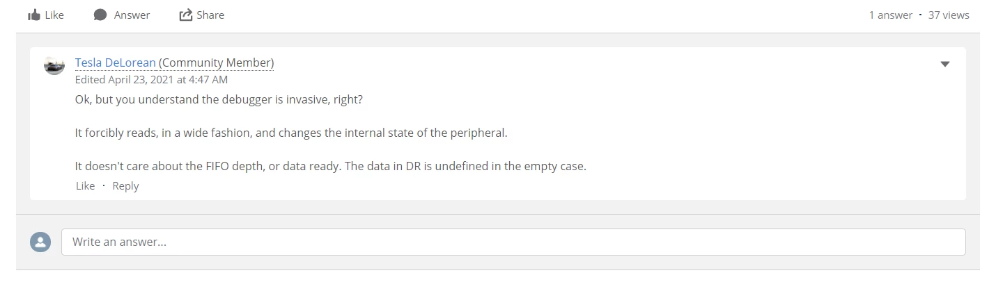

Hello, my problem has been solved. I saw one of your answers in the forum, so I didn't use the online debugging method to observe variables. I think maybe STLINK is consuming my CPU resources and my system clock frequency is only 2MHZ. Thank you very much .0693W00000DlyURQAZ.png

Tesla DeLorean
Guru
August 31, 2021
You've provided very little detail and specifics here.
Attach a minimal example that demonstrates the interaction and illustrates the failure.
Try different clock phase for inbound data.

August 31, 2021
1.I have tried different clock phases.FRAM only supports modes 0 and 3.It doesn't solve the problem.
2.I read data from SPI in two different ways. The first is DMA read,as shown in figure 1.The second is query read,as shown in figure 2. Both of these different approaches can lead to errors.
3.My experimental condition was to write 0 to 255 to FRAM and then read the 256 bytes from FRAM every few milliseconds. When repeated hundreds of times, an error occurs.
4.I have tried to read data using SPI emulation and have no such problem.
5.I present the key code for both approaches below
