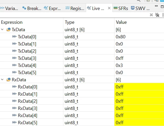

I am currently developing a battery management system (BMS) utilizing the STM32L476RG microcontroller (MCU) and the ADBMS6830 as the analog front end (AFE). Communication between the MCU and AFE is established via SPI. Since the AFE supports isoSPI, we are employing the LTC6820 transceiver. During testing, I transmitted the following data: TxData[6] = {0x80, 0x00, 0x00, 0xFF, 0x03, 0x00}, but the received data was RxData[6] = {0xFF, 0xFF, 0xFF, 0xFF, 0xFF, 0xFF}.
 Is my SPI configuration is correct or not, did I need to do anything more. Please provide some insight about this.
Here is the code :

The debug terminal :

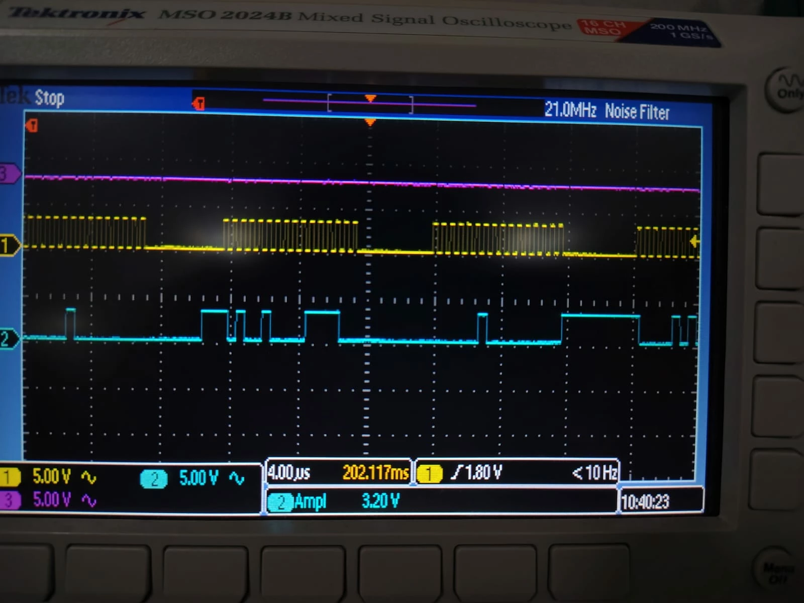

Please find the attached Oscilloscope images:
Blue : MOSI
Yellow : Clk
Pink : MISO

Received SPI data of all 0xFF suggests the chip is non responsive. Perhaps not powered, perhaps wires are not connected correctly.
Your SPI output of the STM32 is correct so the issue is not likely to be an STM32 configuration issue.
I'd recommend probing signals directly at the ADBMS6830. Verify chip select, clock, MOSI, MISO all look as expected.

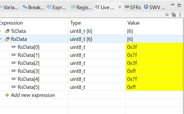

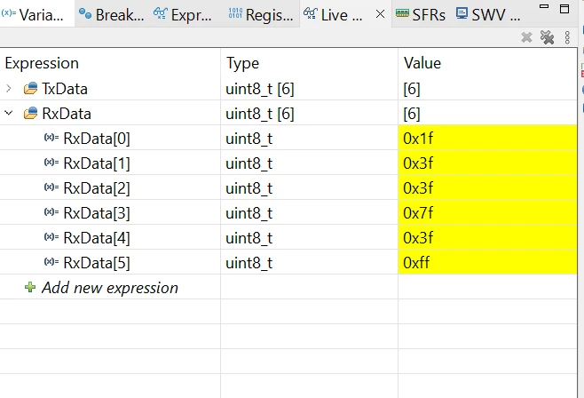

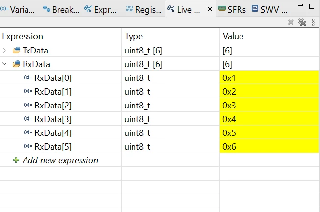

Thank you for your reply.
 I attempted to interface the AFE (ADBMS6830) with the STM32L476RG Nucleo board. Currently, I am receiving the transmitted data along with additional values. I need to verify if the received data is accurate.
I am attaching the debug terminal screenshots. Please provide technical insights.

1. Use TransmitReceive.
2. Read dozens of similar topics in this forum started by beginners having the same problem and look for the explanations.

I agree with @gbm
SPI Transmits and receives at the same time. As bytes are being clocked out, response bytes are clock in.
So you need to use the TransmitReceive call to send a packet which expects a response. Check the timing diagram in the datasheet for the device you are inyterfacing too, it will clearly show the expected bit timings, from which you can see excatly where and when the received bytes come in.

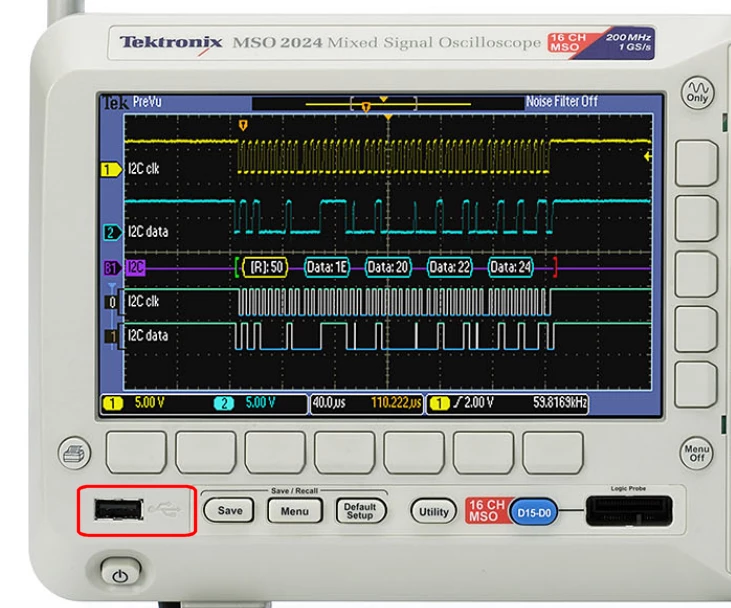

Your scope has a USB socket for capturing screenshots:
This will give you far better results than trying to take photos of the screen!
Are you sure your probes and/or scope channels are correctly configured - for x1, x10, etc?

January 20, 2025
Yes, the probe configurations are correct.
That is not me in the AD forum.

MISO being low suggests there is a drain on that line, or the slave is not able to properly stimulate it. This is due to a power issue or other hardware miswiring or misconfiguration. It's certainly not caused by a code bug.
You're getting a signal, which suggests it's powered and is trying. Perhaps a short to ground somewhere on the board.
