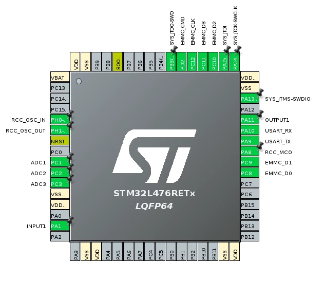

I work on custom board with STM32 chained with SAMAD2 processor on JTAG.
Architecture is that below :
JTAG_TDI -> SAMA5D2 TDI -> SAMA5D2 TDO -> STM32 TDI (PA15) -> STM32 TDO (PB3) -> JTAG TDO
This work fine when STM32 is empty (no code) or when I disable free pin as analog for reduce power consumption. But when I try to enable free pin as analog JTAG chain not working.
I'don't find a particular reason on reading quickly datasheet. Is there any reason to have behaviour.
Find in attachement screen shot of pinout assignement.

Nearly all STM32 have the errata:
2.1.14 Full JTAG configuration without NJTRST pin cannot be used . . . . . . . . 18
So if you change PB4, JTAG will fail.
I wonder why this has never been fixed.

That's explain maybe my problem even if it's talk about debug mode no JTAG TAP.
