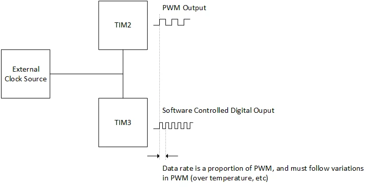

I need to create two synchronized signals.  I'd like to use a PWM output for one, and to have the software create the second signal based on an interrupt from the same clock used to create the PWM output.
I'd like to use STM32CubeMX, but I couldn't find a way synchronize TIM2 and TIM3, or make them use the same external clock source.

    I don't understand. Draw a diagram.
    philipweiss
    October 27, 2017
    Posted on October 27, 2017 at 02:31
    Thank you for your prompt reply.
    I hope that this helps:

    You could use CH1 or both timer connected together to have a common clock source (pin)
    You might also use a single timer with long period and use 2 output channels, the one with slowest period as output compare and the other one using DMA to make burst of pulses during the same period.

    Easiest way is to connect the input signal to the TIXx_ETR or TIMx_TI1 pins of both timers.

    Thank you.  I will verify that I have both pins available.
