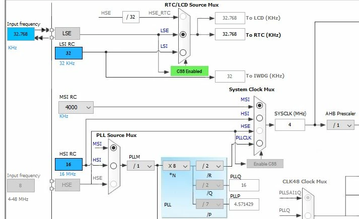

We believe that you enabled LSE in RCC section of the CubeMX and LSE is selected for RTC in the clock tab. If yes, please share the code.
gokhannsahin
Jan 6, 2018 6:51 PM UTC
Posted on January 06, 2018 at 19:51
This is systemconfig function has been generated via cubemx and the errorhandler is called after run the following line.
if (HAL_RCC_OscConfig(&RCC_OscInitStruct) != HAL_OK).

gokhannsahin
Jan 8, 2018 9:24 AM UTC
Posted on January 08, 2018 at 10:24
‌ thank you for your suggestion, although tried on your link, the problem isn't still solved.
The kitwas bought yesterday and only that code was run on it. Furthermore, can't see any oscillation that is similar to 32768Khz in pins of crystal.

Bogdan Golab
Bogdan GolabBest answer
Lead
Jan 8, 2018 10:38 AM UTC
Posted on January 08, 2018 at 10:38
It could be a hw problem but your probe (osciloscope) may affect the circuit and prevents the LSE from starting anyway (during the time when the scope is connected to the circuit). I guess they use pretty low capacitors (4.7-10pF).
I want to say that LSE may does not work but connecting scope may also prevent it from starting so it i snot a prove that LSE is broken.
I can test it on my board but later after work.

gokhannsahin
Jan 9, 2018 11:47 AM UTC
Posted on January 09, 2018 at 12:47
Golab.Piotr
‌ thank you, I break the crystal without knowing it when trying the 32768KHz in order to scope. I have tried to scope the only pin that is routed out of RTC (512Hz) not pins of crystal, finally, it run.Thank you again.:)
Bogdan Golab
Lead
Jan 9, 2018 12:50 PM UTC
Posted on January 09, 2018 at 12:50
Luckily you can use other sources of the clock for RTC...
