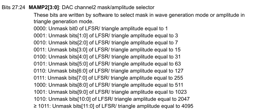

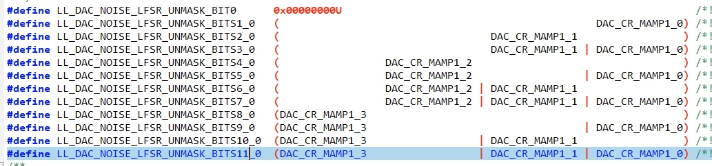

Overall the processor documentation vs. HAL implementation is - to my consideration - incomplete (in most cases, if not all MCU types). For instance:
HAL code defines bit combinations b0000 to b1011:
HAL asserts on codes exceeding b1011:
Even if HAL doesn't write binary codes above b1011, the datasheet clearly states ">= 1011" is valid (and has a known behavior). Sometimes a work-around for missing HAL options is to write IO directly (not that I'm in favor, because you this may lead to unexpected behavior). If one writes as such an assumed functional binary code that later on causes an assert that is often very hard to understand/debug. Besides that, I located several cases where HAL implementation is even completely wrong encoding such bits (I encountered cases where the manual stated b11xx are all same functioning as b1100. The HAL code used a series of "?" statements where it ended that as readvalue == CODE_12 ? 12 : 0 -> what is completely wrong since all codes above 11 are considered by hardware to be 12.
