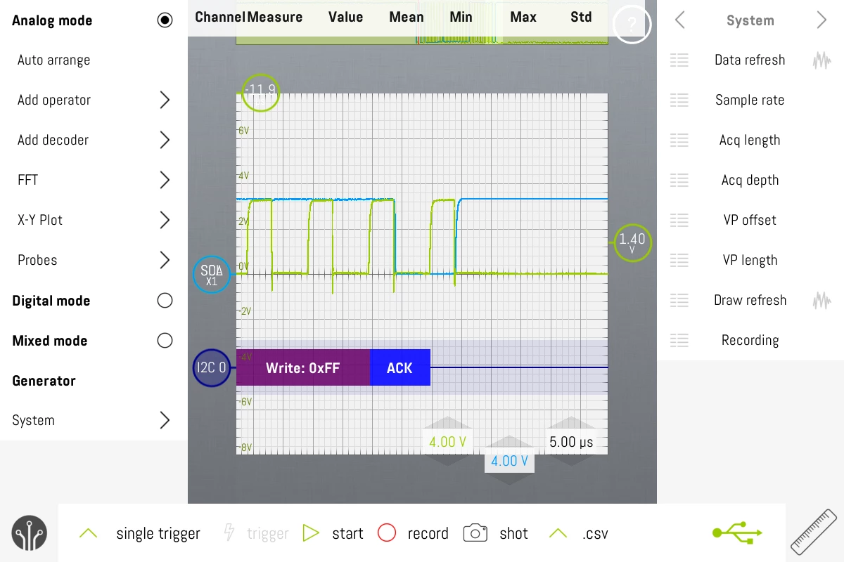

Hi All,
I've been struggling with this for a while now. I have designed a new board based on the STM32L476 to replace an old design using a PIC. I cannot for the life of me get the I2C to work.
I have used STMCubeMX to pinmux and configure / generate the startup code for the board and write my code in Keil.
The bus (I2C1) currently, only has an eeprom connected (CAT24C512 at address 0xA0). I have two 1K pull-ups, pulling up SDA and SCL. I am attempting to operate at standard I2C speed (100KHz).
I can get an 'ack' from the device, but when trying to use HAL_I2C_Mem_Write, the micro sends the first two address bytes, then nothing. SCL stays low after the second ack (before the repeated start).
Both SDA and SCL look good.
Here is the application code:

}I have attached a schematic containing the sheet with the STM32L476 and I2C memory on it.
