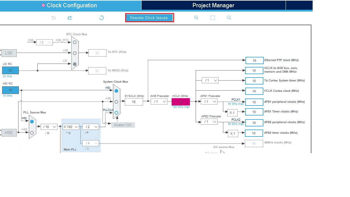

    Hi, I tried following the instructions in the presentation with the latest CubeMX 5.0.1, but when I got to Generate Code it popped up a message "These IPs still have some not configured or wrong parameter values [Clock]. Do you still want to generate code ?". Is that something that can be ignored for this example ? Thanks.
    January 28, 2019
    You have to configure the clock before generate code.
    You can click on the "Resolve Clock Issues" button to resolve automatically your configuration issues .
    0690X000006DGVMQA4.pngKind Regards,
