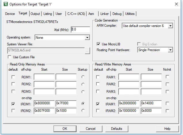

Hi everyone!
I’m working with a STM32L475RE design. The project works completely fine in “debug mode�? (using ULINK2) but doesn’t work in release mode.
I’m trying to find the code part that could be the problem, using a LED on the initiation. However, it seems that the MCU doesn’t starts. Could be a clock problem? I’m using systick time base . Below you can see my SystemClock config:

I don’t understand why it’s working in debug, but not in normal mode. Please, any help/idea?

    Tesla DeLorean
    Guru
    February 26, 2019
    Make sure BOOT0 pin is pulled LOW externally
    Instrument you code, and failure paths so you know what is happening.
    The Error_Handler() and HardFault_Handler() being of particular interest if the application dies there.
    JosepM Ribera
    February 27, 2019
    Thank you for answer.
    It seems solved! If could interest to anyone:
    it was due to the "Memory Areas" configuration that I had. Now, it's working fine
    It was due to the "Micro Lib" selection.
