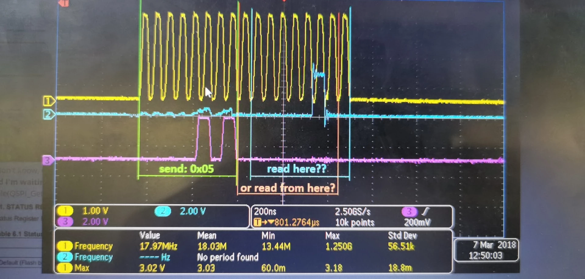

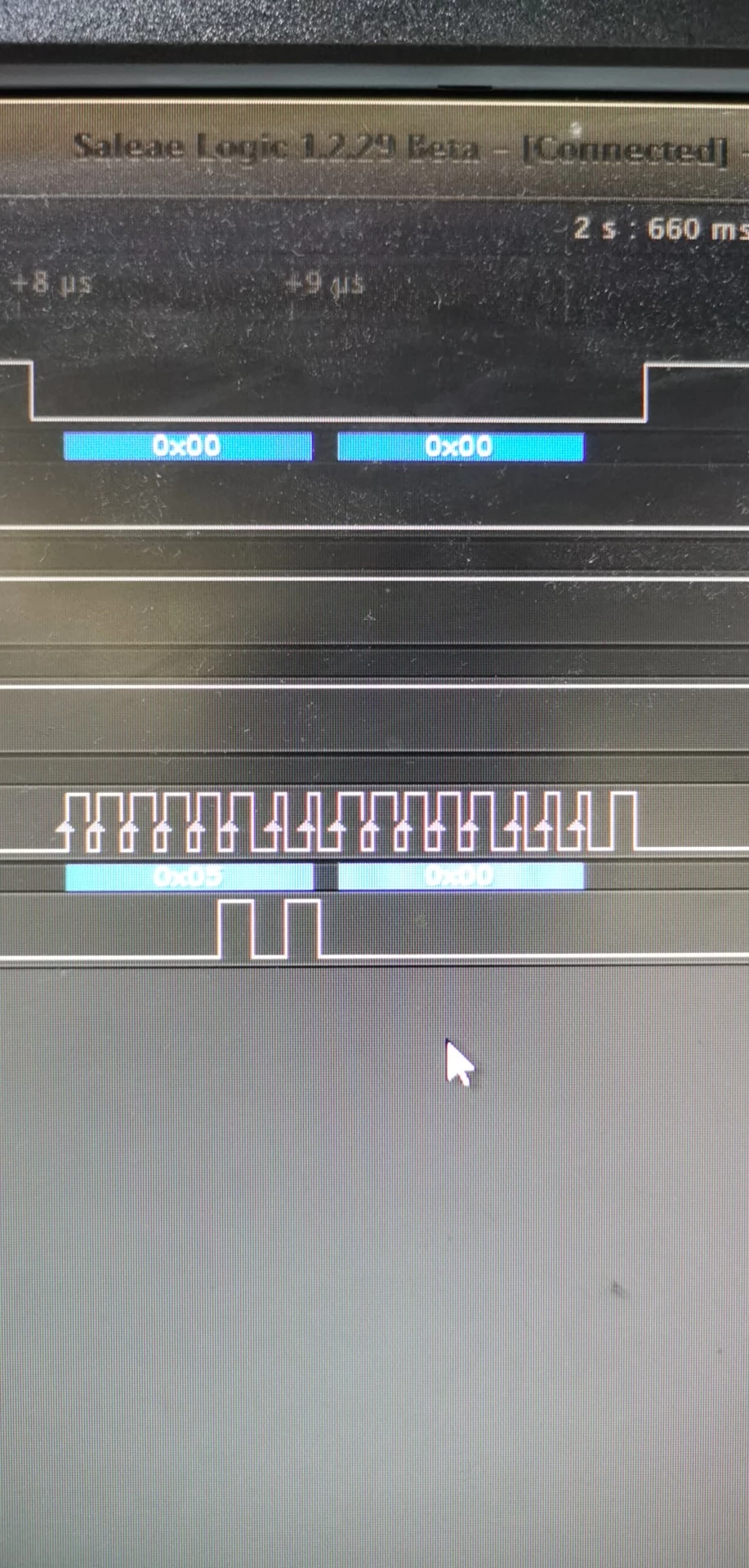

STM32L475 QSPI read extern flash status register(0x05) 9 clock.

lwen.1
lwen.1Author
March 23, 2020
a lot of extern flash require the clock accurate,so the last( 9 clock) is not allow.
lwen.1
lwen.1Author
March 23, 2020
I don't know the problem happen where (the QSPI hardware or the read extern flash register program is error), I wish anyone can help me, thank you very much.
lwen.1
lwen.1Author
March 24, 2020
I configure the QSPI to single Dual-Spi is also find the 9 clock.
anyone find it bugs
