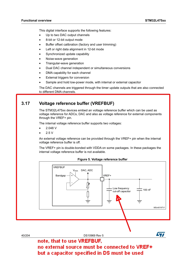

Thanks, that could indeed explain the behavior we are seeing, since we are powering Vdd with 3.3V.
Since the application requires a stable ADC reference, I would like to ask whether the STM32L475 provides any internal precision reference that can be selected as the ADC conversion reference.
    1 reply
    waclawek.jan
    Sep 17, 2026 9:50 AM UTC

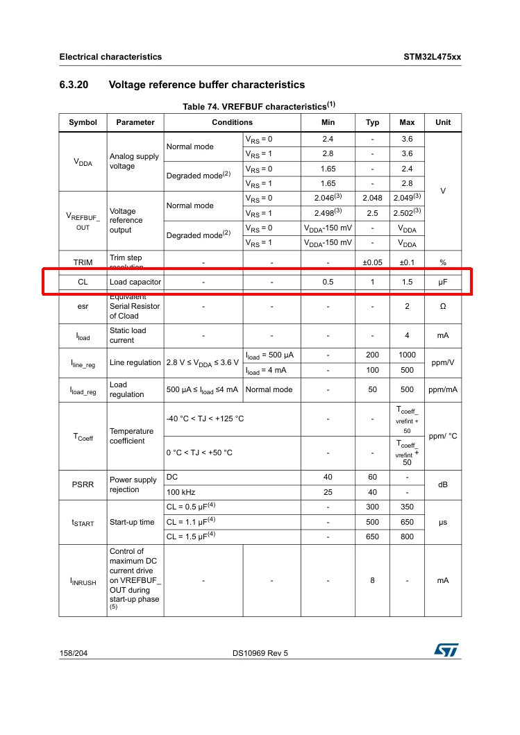

    Yes: the VREFBUF module.
    It is not *selected* as ADC reference: ADC reference is *always* the VREF+ pin. The way how to use the internal VREFBUF is, that you don’t connect external voltage to VREF+ pin and you switch VREFBUF on (see the VREFBUF chapter in Reference Manual).
