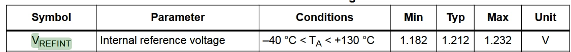

When measuring several analog input voltages, the ADC results consistently do not match the expected values assuming a 2.5V reference. I found that the measured ADC values correspond much more closely to an effective reference voltage of approximately 2.62V rather than 2.5V. To further investigate, I measured the internal VREFINT channel and compared the ADC result against the value expected from the datasheet, and assuming a 2.5V reference, the VREFINT result (1.167V) does not match the expected value:

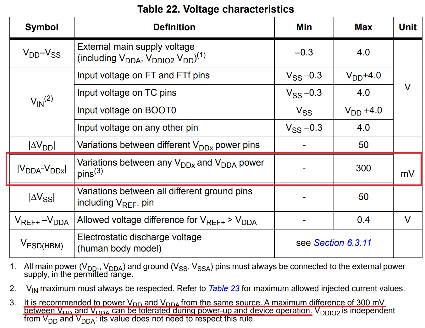

Hello ​@Marcel Calleja Álvarez and welcome to the ST community,
VDDA and VREF+ are tied together and supplied with a precise 2.5V reference.
If your VDD = 3.3V, you can’t use that configuration as per the datasheet, |VDD-VDDA| cannot exceed 300mV:
As you are using a LQFP64 package, VDDA and VREF+ are tied together internally,  you can’t use 2.5V as reference voltage for Vref+ if your VDD = 3.3V.
