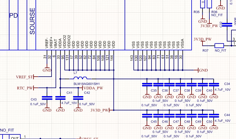

I want to use STM32L471ZGT to write a rare signal to flash. All the rest of the time it should consume as little as possible. I config RTC for alarm (and then try wakeup), all working
perfectly if ambient temperatures -10C and above. But processor don't wake-up from standby and shutdown modes at ambient temperatures below -10..15C.
LSCO gives a good signal at the same time! RTC counters also working!
It wakes up when it heats up.
Tell me which way to look for the problem, pls.

    Does it not react to NRST either? Is VDDA properly decoupled to VSSA? Double check also the soldering of the pins.

    0690X000006CMb7QAG.pngWhen I close nRST to GND in the fridge, processor restarting ok.
    I have 4 devices, everyone behaves the same.
    Power pins decoupling on the picture.

    where do you connect the RTC_PW ?
    and Vref_ST ?

    RTC_PW internaly connected, power in my system always preset.
    Vref_ST 4.7uF to CND.
