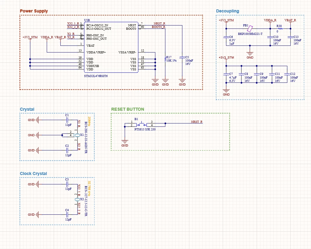

What is the clock? How is it used? Is there any LSE clock/VBAT? You may perhaps want to post relevant portion of schematics.

Attaching clock configuration, can provide more info if needed. I also added the init of the periphs...
Added the schematics for the clock HSE and LSE, and power inputs.

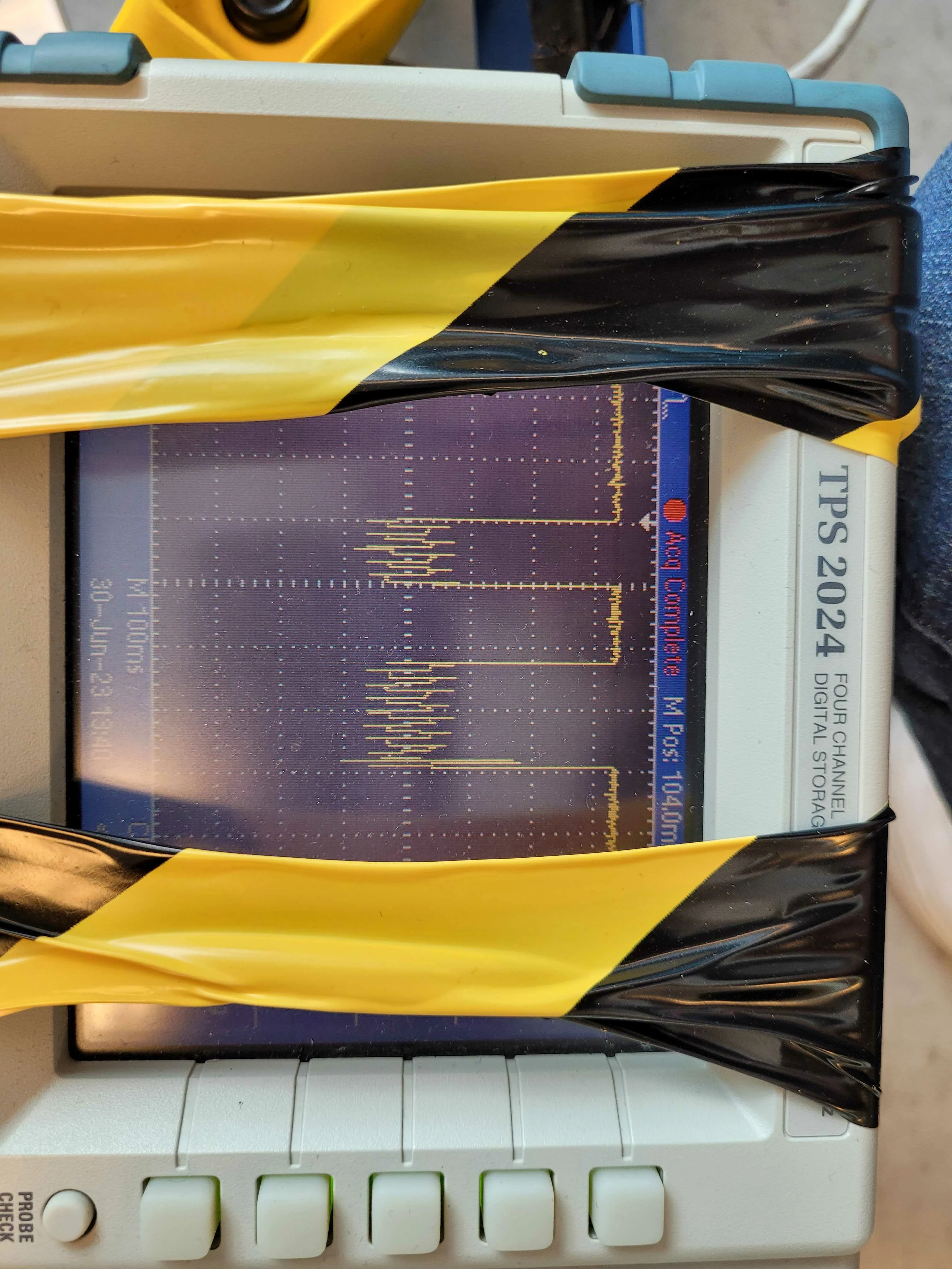

Explorer
July 17, 2023
Hi there,
I'm a collegue of these two guys. So by "lockout mode" @ARed  means that STM enters an unknown state at which it doesn't do anything and it can not be reset either internally (watchdog) or externally by NRST pin pulling low.
However, at this state the internal watchdog triggers as if it tries to reset the STM, but the chip doesn't come back. Once in this state, STM will stay "stuck" until the battery is running-on, drains. The only way to reset it is to reset power (e.g. unplug battery).
What you mentioned about VBAT brownout erratum might be relevant here.  While monitoring some pins to try and capture something with an oscilloscope, we saw that when this occurred there was a dip in the STM power line, which is the same for VBAT. I add a picture here to show that better.
The scale here is 1V/div.
waclawek.jan
July 17, 2023
How do you know that? Can't it be running in its internal bootloader? Or stuck in some unhandled error, or in a loop during attempt to start up? Maybe using a debugger could reveal that.
Nonetheless, if the waveform you've shown is VBAT, regardless of whether it is connected to VDD/VDDA or both, if it goes below ground i.e. to negative as much as you've shown, that may be a concern too, and may have resulted in latchup; so you may want to eliminate that possibility first, by reviewing the power supply arrangement.
