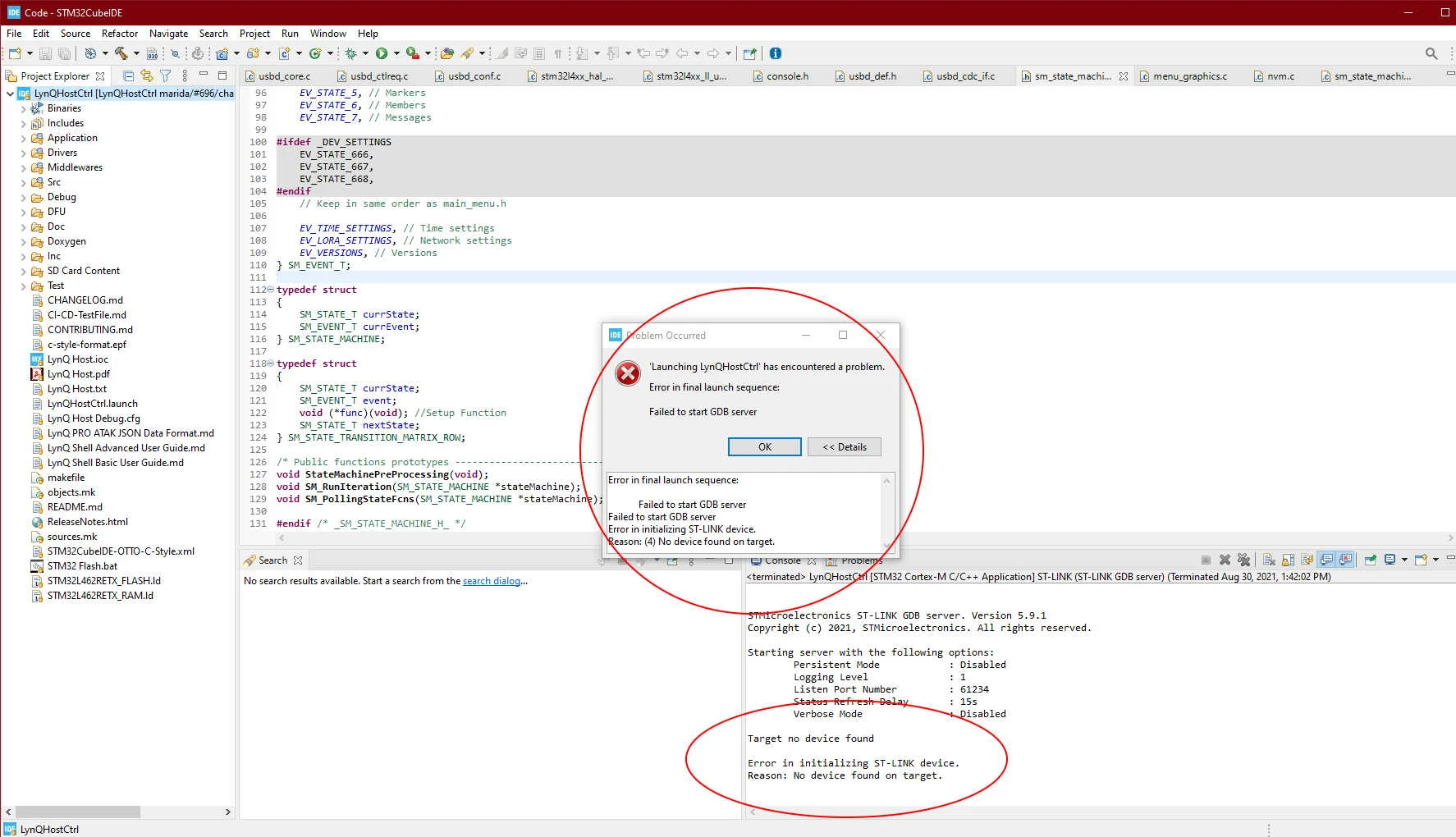

I have STM32CubeIDE 1.7.0 issue whereby I can connect either ST-Link V2 or V3set to our custom board that has STM32L462RET6 MCU. Same with STM32 Cube Programmer - can't connect - target not found. Inside IDE, there's problem launching GDB server.
Please see attached images of the problems.
Whether I connect our board, power it on or disconnect it from ST-Link, it's the same results - either way, it can't find target board.

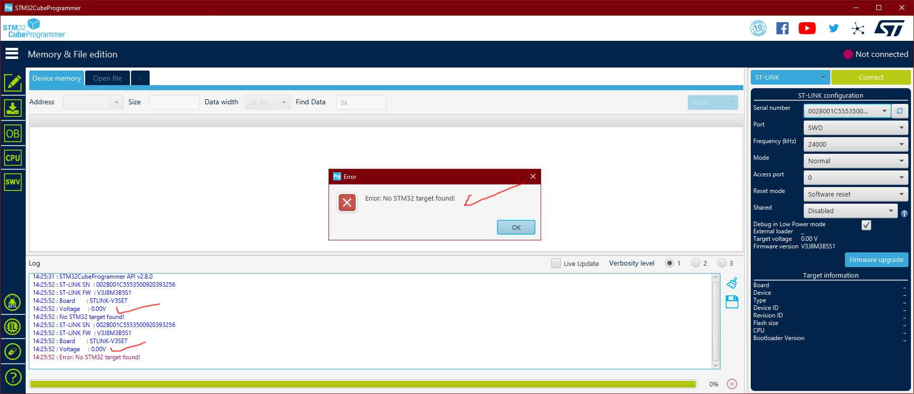

In Programmer, I noticed, whether Voltage: 0.0 (STLink V3) or Voltage 3.24 (STLink V2) is detected, STILL target can't be found.
How can I fix this issue?
Thanks for your help.
STMicroelectronics ST-LINK GDB server. Version 5.9.1
Copyright (c) 2021, STMicroelectronics. All rights reserved.
Starting server with the following options:
    Persistent Mode      : Disabled
    Logging Level       : 1
    Listen Port Number     : 61117
    Status Refresh Delay    : 15s
    Verbose Mode        : Disabled
    SWD Debug         : Enabled
Target no device found
Error in initializing ST-LINK device.
Reason: No device found on target.

> our custom board
Would indicate the chip doesn't have power, or that it's not wired up to the debugger.
Most likely scenario is a hardware problem. Check voltage rails, VCAP voltages, verify correct orientation, verify SWD connections make it to the chip.

Thanks for your reply. It was all my fault.
I had the V3 adapter board 180 degrees wrong way assembled to the main STlink board ☹ Someone looked more closely & saw that.
And I unknowingly plugged in the tag connect to the V2 on the STM8 connector because I borrowed it from someone to isolate V3 problem.
He had the interface board on the STM8 location instead on the STM32.
I’m new to this ST MCU, IDE, programmer, debugger so I learned GOOD LESSONS here.
I apologize for the bother to you.
