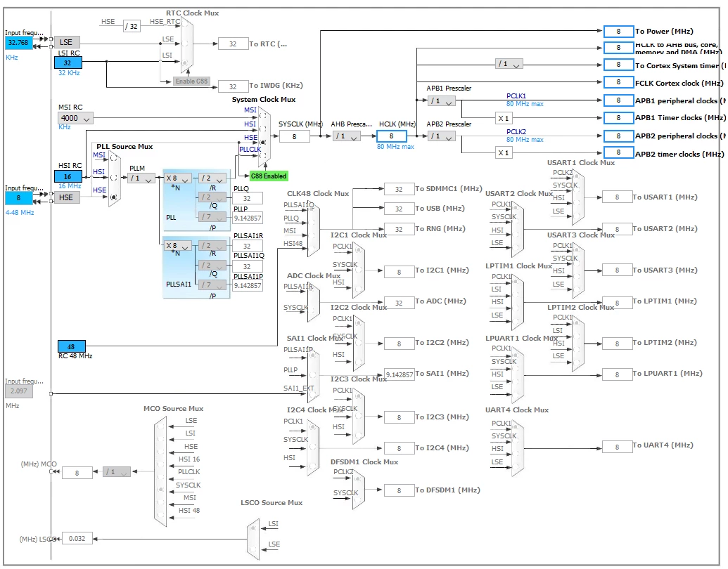

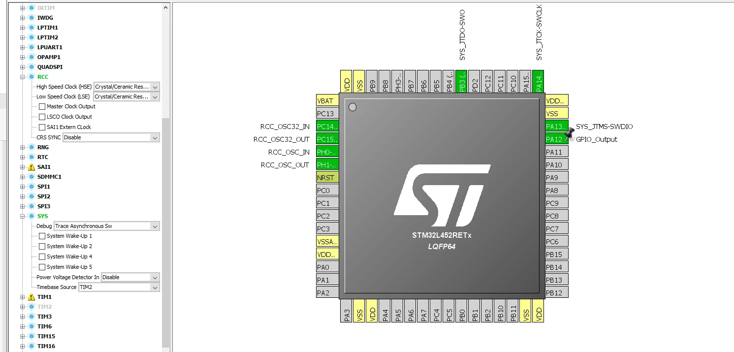

Hello, Help me please. I configuration STM32L452RET6 in the CUBEMX, how on the pictures. Then I build project in the Attolic and go to debuger and then when MCU is starting work, it go in the HardFault_Handler(void) through 1-5 seconds. Why? I can't find problem. Maybe anyone know?
Crystal clock is Abracon LLC ABM9- 8.000MHZ-10-D-1U-T.

Perhaps your Flash settings (wait states) are not correct ?
I would try with a reduced core clock.

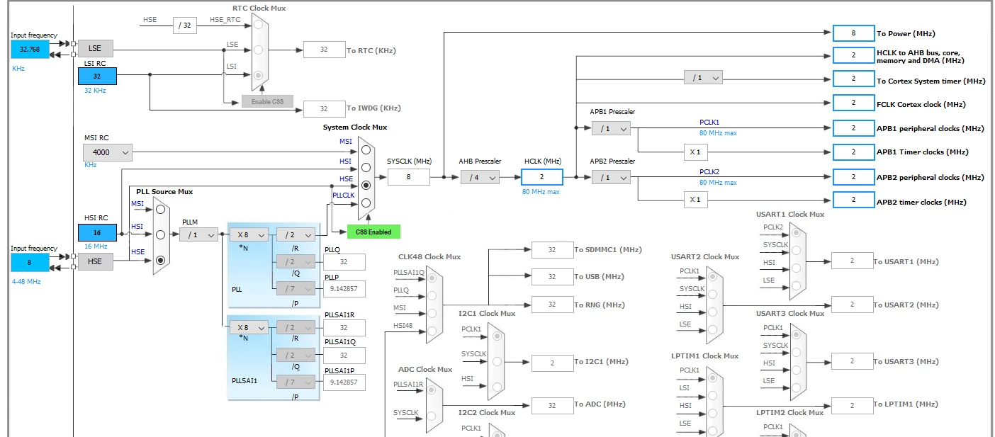

Anton Doinikov
July 10, 2018
Posted on July 10, 2018 at 12:10

Look at the code that is actually faulting. Ideally outputting diagnostic information to USART or SWV
Try also clearing the structures when allocating from the stack
RCC_OscInitTypeDef RCC_OscInitStruct= {0};

Isn't this one of the known CubeMX bugs ('does not set one of the PLL parameters')?
[EDIT]
https://community.st.com/0D50X00009Xkh6lSAB
