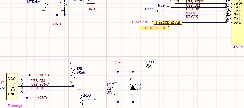

May 6, 2024 12:52 PM UTC
Mass storage class showing same issue, detecting on Windows, but not detecting on Android.
The external clock (HSE) using now.
Below showing the schematic in which USB_DM and USB_SYNC is interchanged. Is there any possibility to work the USB in windows, if this pins are interchanged?
AScha.3
May 6, 2024 1:18 PM UTC
No - hey, but everything is possible in certain reality. :)
If really mixed up - correct it. And try connection then...
May 6, 2024 2:13 PM UTC
