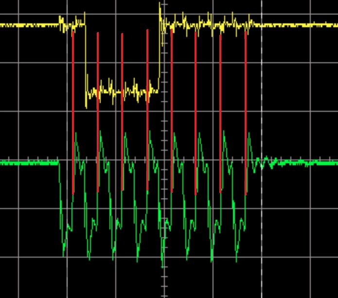

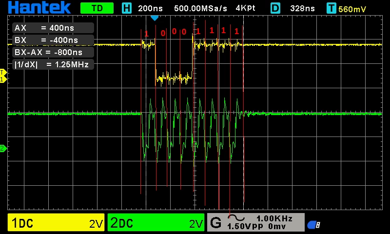

Hi, Its my first post. Im trying a STM32L452 and IIS3dwb on SPI2 (SPI2_CLK on PB13). When I send the WHO_AM_I command, the SPI2_MOSI send only 0x0F instead 0x8F (0x0F OR 0x80). SPI2 setup is CPOL = High, CPHA = 2 Egde, 8 bits, MSB First, Baud Rate = 10MHz. PB1 is CS for IIS3DWB.
Acc = IIS3DWB_RegRead(IIS3DWB_WHO_AM_I);
unsigned char IIS3DWB_RegRead(unsigned char reg) {
unsigned char value = ((reg & 0x7F) | 0x80);
HAL_GPIO_WritePin(ACC_CS_GPIO_Port, ACC_CS_Pin, 0);
HAL_SPI_Transmit(&hspi2, &value, 1, 5000);
HAL_SPI_Receive(&hspi2, &value, 1, 5000);
HAL_GPIO_WritePin(ACC_CS_GPIO_Port, ACC_CS_Pin, 1);
return value;
Where am I going wrong?
Thanks!

That signal is definitely 0x8F.
fmaessoAuthor
October 26, 2023
I'm ashamed!
sorry
Thanks
waclawek.jan
October 26, 2023
Why do you think so? To me, this looks exactly like 0b10001111 = 0x8F (in SPI mode 3 as required by the sensor).
